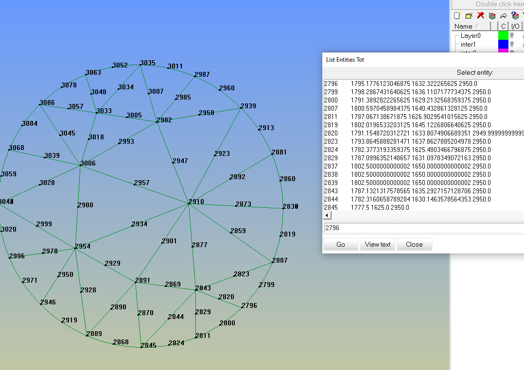

I am currently working with GID and more particularly on surface meshes. However, I have a problem: when I create the mesh, the nodes created in a surface are not consecutive (see screenshot below). Does anyone know how I can force the mesh to create consecutive points on this surface? I want to be able to define this surface with a “continuous” range of points.

Nodes are renumbered at the end of the mesh generation with different algorithms, depending on the value of the GiD variable
RenumberMethod
but in fact the kind of numeration that do you want (consecutive on each surface) is in general not possible, because nodes are shared between neighbor surfaces, then the id for a surface could be incompatible with the id for other surface
In any case, independently of the numeration, you can know the nodes of each surface with different approaches. e.g.
a) -you can create a group by surface, and then the nodes will inherit the same group
b)- with a problemtype you can assign to the surfaces a condition with a special question field #FUNC#(NumEntity)
QUESTION: Surface_number#FUNC#(NumEntity)
VALUE: 0
that will be automatically filled with the source surface number
c) In next GiD 15.1.5d developer version (available in few days) as new the geometric entities will store its mesh entities, and then could ask (without the tricky probemtype condition) for the id of the geometry, with this GiD-Tcl scripting commands:

Hello Escolano,
Thank you very much for your answer. I have, for the moment, manually typed the coordinates of the nodes and cells corresponding to my surface, but your idea works too. In the future I will have another problem because I will have to look at surfaces that are not the same but belong to the same layer. Do you know if it is possible to export in the same way as “Files/Export/Text data report …”, a file that would allow me to obtain the same formalism as this export (i.e. the coordinates of the nodes under “MESH dimension 3 ElemType Quadrilateral Nnode 8” in the text file for example), the list of cells belonging to a layer?
