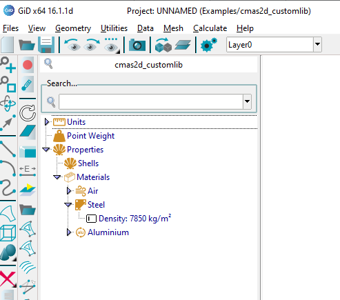

load the problemtype Examples/cmas2d_customlib
you will see a tree like this

If do you want for example ask for the ‘Density’ of the material named ‘Steel’ , can see in the XML that in this problemtype the materials are in a node named ‘container’ with an attribute ‘n’ with value ‘materials’ and then several child nodes named ‘blockdata’ with an attribute ‘n’ with value ‘material’ and we want the one that match the attribute ‘name’ that we want to ask.
then we use an xpath like this
set x_path “//container[@n=‘materials’]/blockdata[@n=‘material’ and @name=‘$material’]”
and inside there are sub-childs with name= ‘value for each question, and we want the one with attribute ‘n’ equal to our question to ask
set x_path_3 ".//value[@n=’$question’]"
