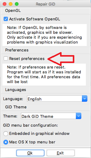

You can also reset all preferences if you:
  1. go with the Finder to the Applications folder
  2. on the GiD icon, right click and selec ‘Show package contents’
  3. a new Finder window will pop-up showing the contents of /Applications/GiDxxxx.app/
  4. go to Contents/MacOS
  5. double click on ‘GiD_Sage_Mode’
  6. a window will pop-up like the attached one.
  7. Click on the ‘Reset preferences’ checkbox
  8. Press the ‘Ok’ button
