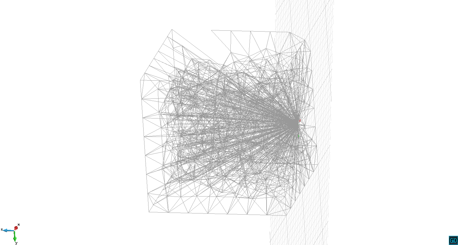

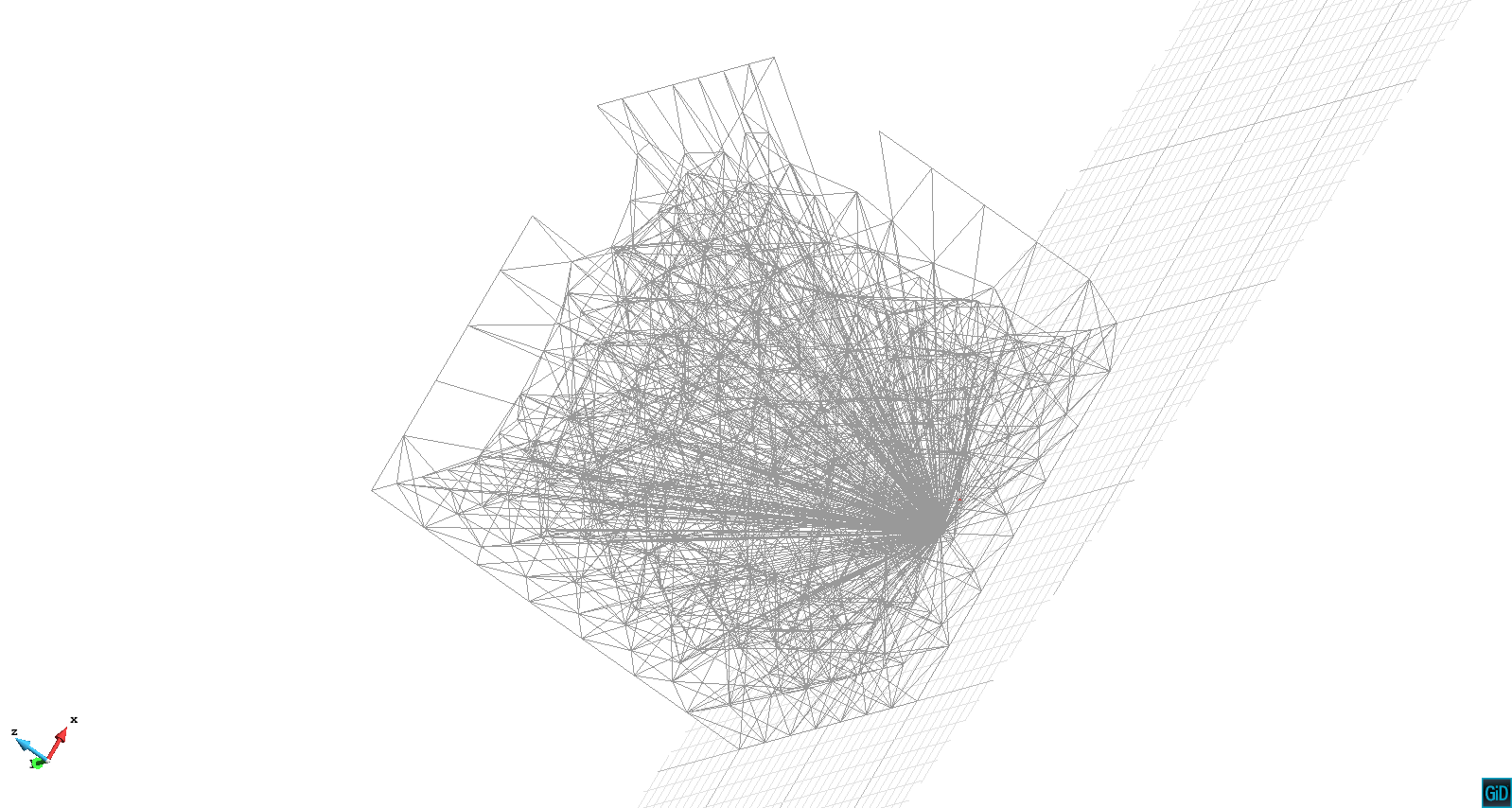

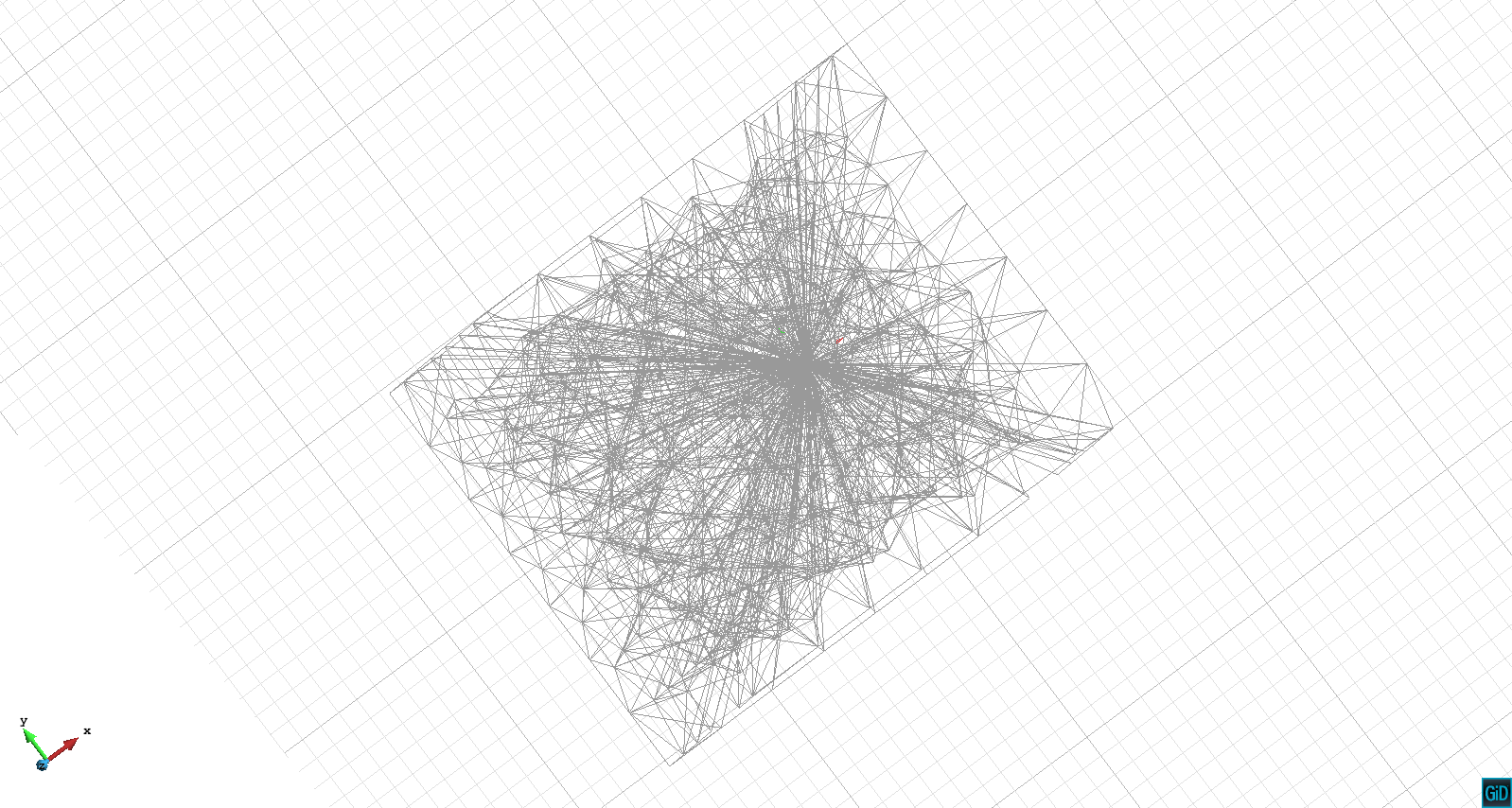

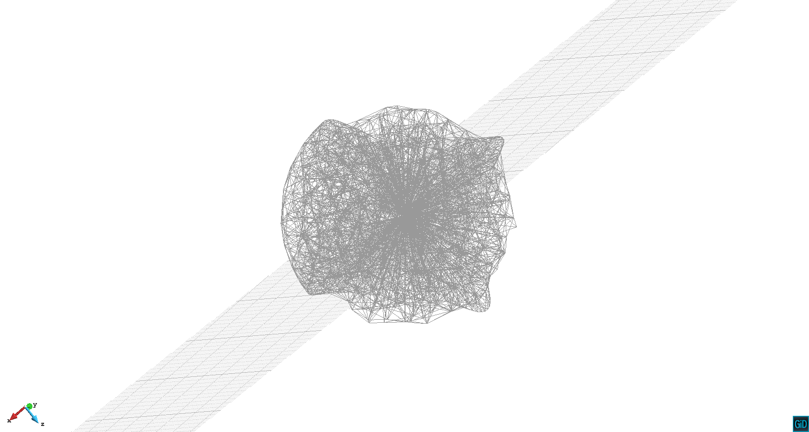

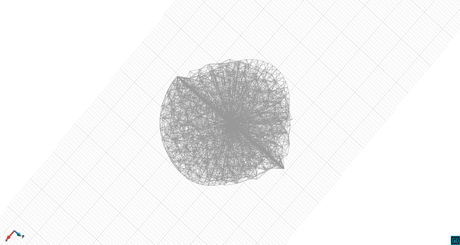

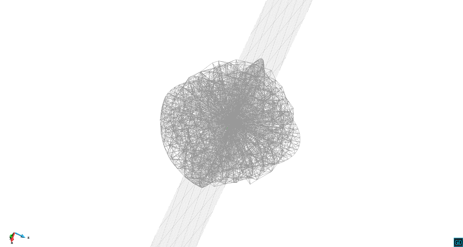

The result of mesh is obtained when I generate mesh for the cube volume.
I thank the situation is bad .
A bug of the gid V13???
or
There are some wrong of my operation!!!
please help me?

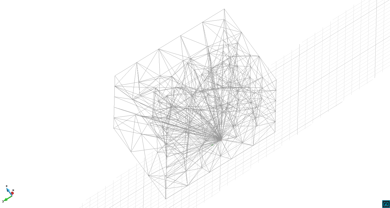

the same to cube volume

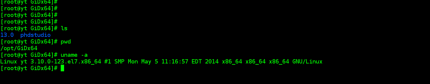

gid boot informationScreenshot from 2016-07-11 22:38:01.png
my os is redhat enterprise linux 7 64bit

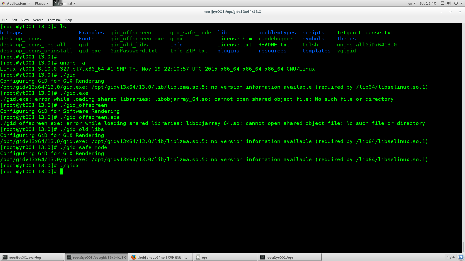

[root@yt001 gidv13x64]# cd 13.0/
[root@yt001 13.0]# ls
bitmaps Examples gid_offscreen gid_safe_mode lib problemtypes scripts Tetgen License.txt
desktop_icons Fonts gid_offscreen.exe gidx License.htm ramdebugger symbols themes
desktop_icons_install gid gid_old_libs info License.txt README.txt tclsh uninstallGiDx6413.0
desktop_icons_uninstall gid.exe GidPassword.txt Info-ZIP.txt plugins resources templates vglgid
[root@yt001 13.0]# ./gid
Configuring GiD for GLX Rendering
/opt/gidv13x64/13.0/gid.exe: /opt/gidv13x64/13.0/lib/liblzma.so.5: no version information available (required by /lib64/libselinux.so.1)
[root@yt001 13.0]# ./gidx
[root@yt001 13.0]# ./gid_safe_mode
[root@yt001 13.0]# ./gid_offscreen.exe
./gid_offscreen.exe: error while loading shared libraries: libobjarray_64.so: cannot open shared object file: No such file or directory
[root@yt001 13.0]# ./gid.exe
./gid.exe: error while loading shared libraries: libobjarray_64.so: cannot open shared object file: No such file or directory
[root@yt001 13.0]#

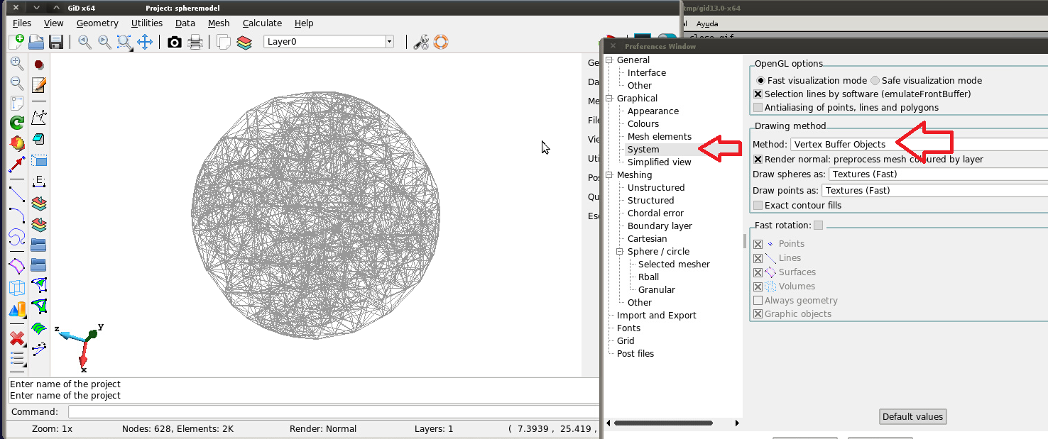

Hi zyex1108,
Several things:
  1. I could open your GiD models without any problem:
    So the problem may lie in the graphics related.
    Please, in the Utilities–>Preferences window go to ‘Graphical–>System’ under the ‘Drawing method’ select Display lists instead of ‘Vertex Buffer Objects’ (look ad the red arrows in the picture above).
    Does this solve your problem?
Can you send the information that appears under Help–>About → More… button?

Does the problem persist when you go to ‘/opt/gidv13x64/13.0/’ and run ./gidx ?
Can you send us the output of ‘cat /proc/cpuinfo’ ?
  1. the problem with:
    The library is inside the gidx64/13.0/lib folder.
    You should start gid with ‘gid/gidx/gid_offscreen’ and not with gid.exe or gid_offscreen.exe
    gid/gidx/gid_offscreen are scripts that sets the appropiate environment variables so that gid.exe can find the dynamic libraries.
