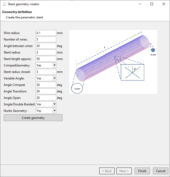

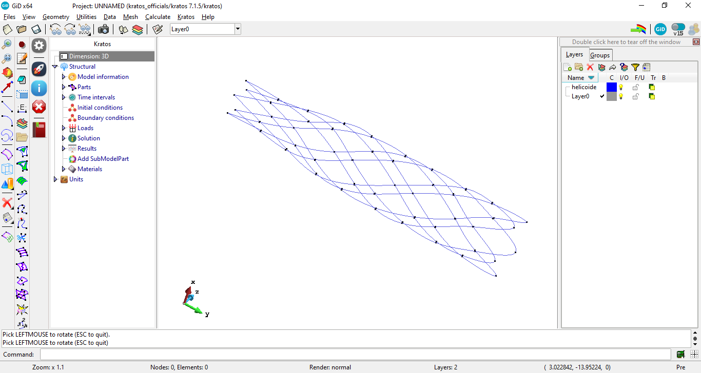

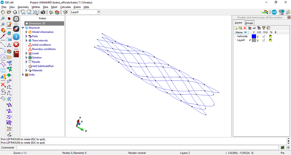

A similar case, to create medical stents, has been solved writing specialiced Tcl/Tk scripts that create a model of curves from some parameters.
The images are of the kratos 7.1.5 stent application

It seems that Ruben Otí­n has wrote a specialized Tcl/Tk scripting to generate the GiD geometries,
similar to the images that I have shown to create stents
