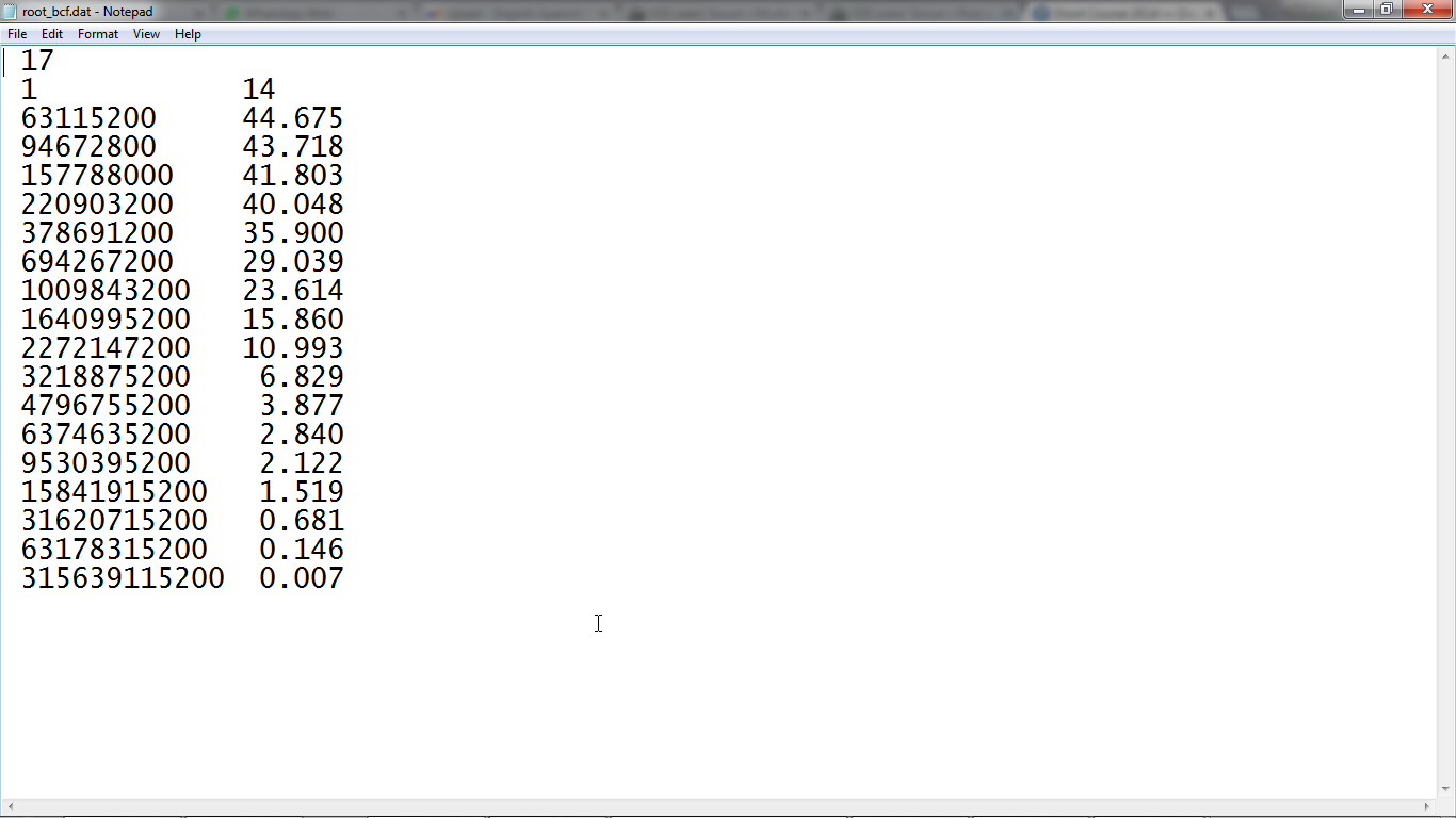

Hello Vojta,
Here you have a picture of an example bcf file.
About the delimiters, you can use spaces.
You can get an explanation about the bcf file in the Code_Bright_Users_Guide (page II.29) and also in tutorial III (thermal problem). Please make sure your file has the correct name: _bcf.dat
Hope it helps.
The Code_Bright Team
