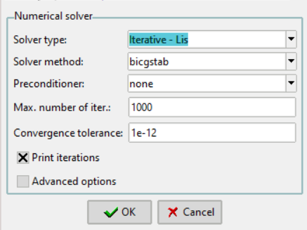

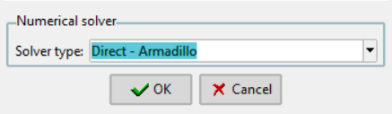

  • Behavior with GiD version 14:
    A double cick in the container “Numerical solver” in data tree open the following window:
    If the value is changed in the box ‘Solver type’ to ‘Iterative - Lis’ option, the window in the data tree is resized to contain more information:

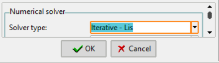

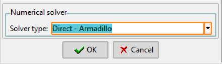

  • Behavior with GiD version 15:
    A double cick in the container “Numerical solver” in data tree open the following window (similar to version 14):
    If the value is changed in the box ‘Solver type’ to ‘Iterative - Lis’ option, the window in the data tree is not resized, but a scrollbar is added:

You are right that the ‘old behavior’ looks better for a case like yours.
But the ‘new behavior’ solve a problem (a lot of fields or a small screen size) with an ‘scrollable container’.
What happen if the problemtype define more fields that the available screen space ?
Then the last fields become unfeasible: the user is not able to see or fill them!!
We will try to enhance the current behavior in next GiD versions, to look better in several scenaries, but It is difficult to have good control of sizes with scrolled widgets.
About the trick that you want to do: yes, you can set this Tcl global variable to 1 to have the old behavior
set ::CUSTOM_LIB_WINDOW_VALUES_SCROLLED 1
you can do it for example in the event of load your problemtype
