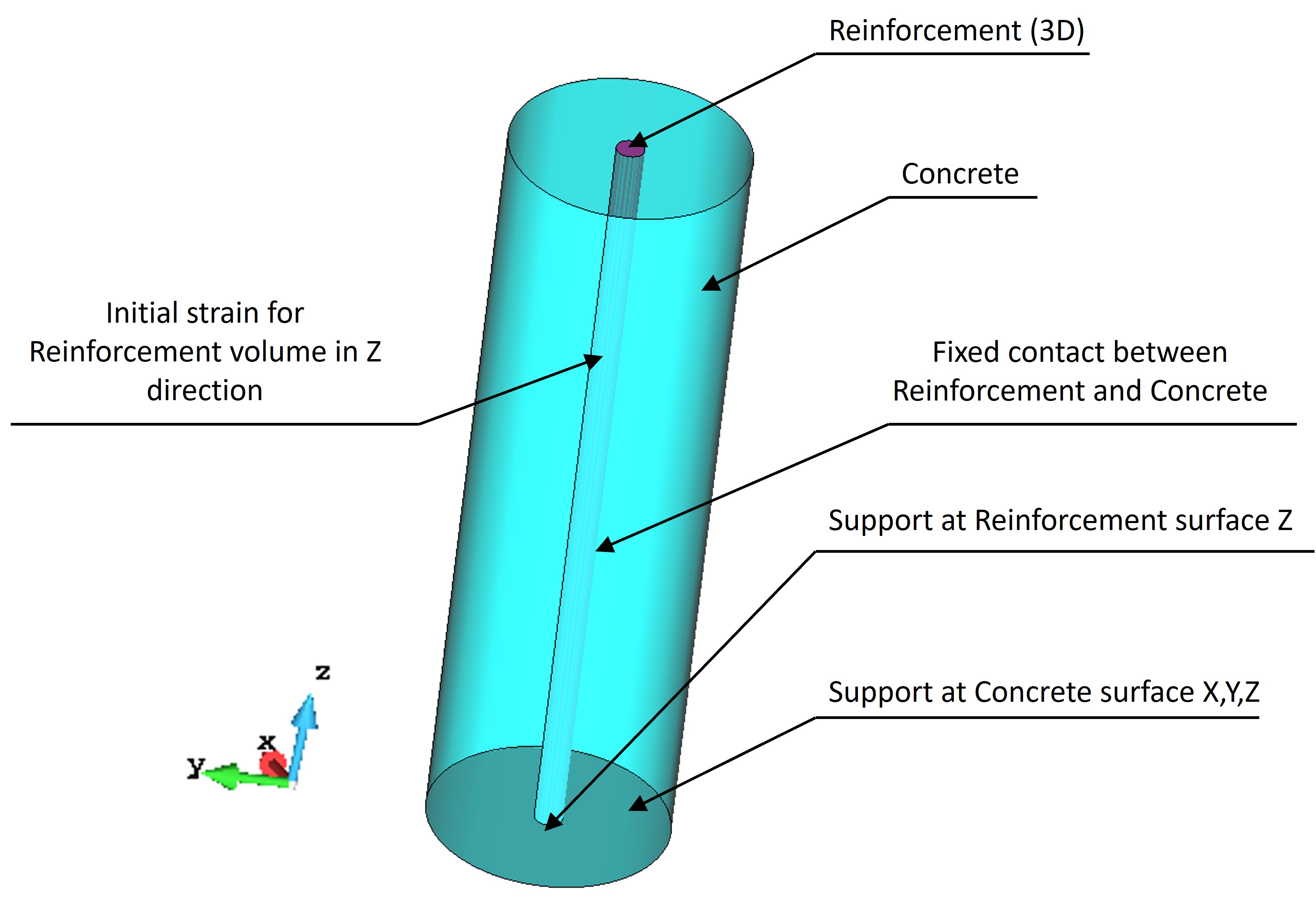

I am writing to seek guidance on applying prestressing load on a 3D cylinder of steel in my model. Specifically, I have embedded reinforcement within a concrete cylinder, with the reinforcement created as a 3D cylinder and defined as solid steel (Steel VonMises 3D) and the concrete cylinder defined as solid concrete (Cementitious2). I have set a (constraint for surface) condition at the cut surface in the longitudinal direction and a (fixed contact for surface) condition between the reinforcement and the concrete.
To apply the prestressing load, I used (initial strain for volume) and applied the strain in the longitudinal direction. However, it appears that my approach did not work well. I have attached the GiD file for your reference.
