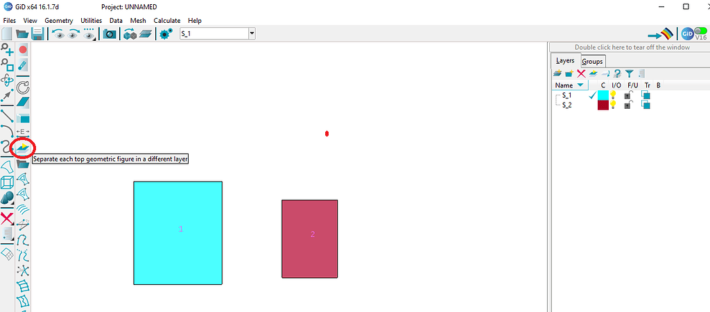

In GiD for example you can use the macro button to send each ‘top-level’ entity to a new layer
or can send to a layer some entities and its dependent lower-entities
and while selecting surfaces or curves in the contextual menu the ‘Connected tangent’ command will add to the selection the entities connected with the current ones that are tangent with a tolerance angle (that could be set to 180 degrees for example to select all connected without take into account its normal)
