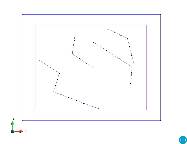

It exists an option
Mesh->Mesh criteria->Force points to->surface mesh…
Unfortunately doesn’t exists an option like ‘force lines to’, but maybe the first one can aid you.
First use the tool
Geometry->Edit->Divide lines->Num divisions (or Length)
to divide the crack lines to create points at similar distance of the required mesh size.
the use
select the surface, and then the points of the crack lines.

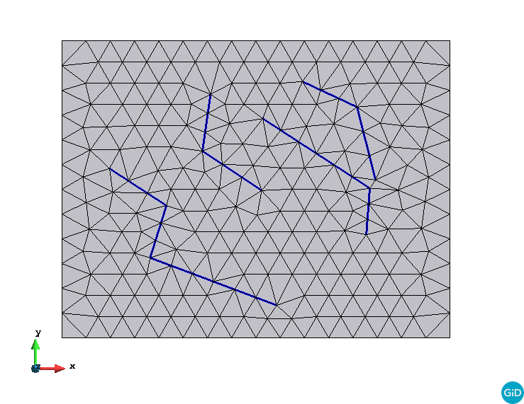

Then generate the mesh. If you are lucky maybe the triangles generate will non only use the forced nodes, but also the edges of the triangles match these lines.
see my pictures:
