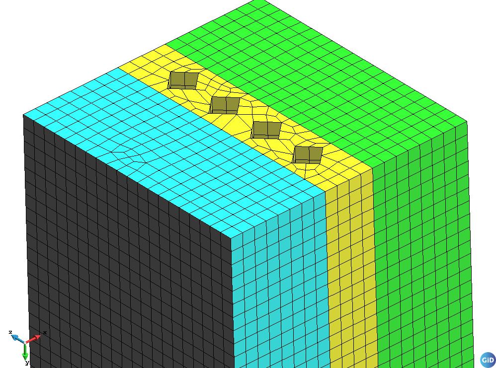

Hi Escolano,
I hope this message finds you well.

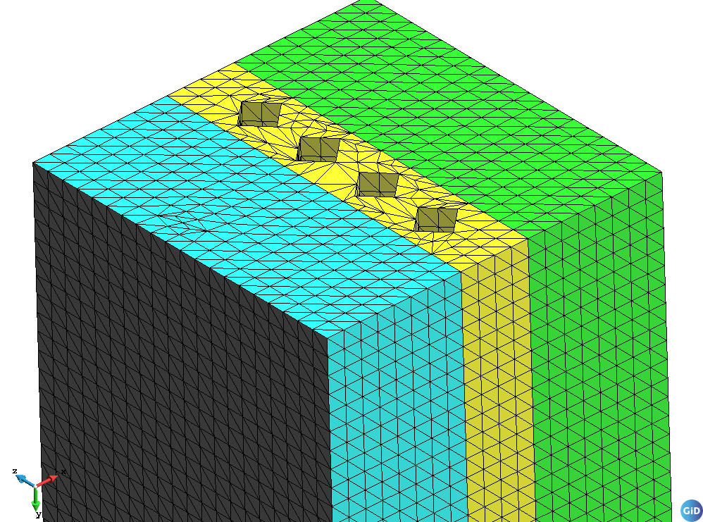

I have a model where I can't mesh it properly around the opening, so I partitioned it into three parts and after meshing, I want to split hexahedral meshes into tetrahedral ones. This doesn't happen when I want to split tetrahedral meshes. I have attached my model.
Many thanks for your time, and kind consideration.
Best regards,
Hamed
GID16NoInterfaceFullyDenseAverage20Divisions.gid.zip

And about split hexahedra to tetrahedra you can do it directly in the mesh with
Mesh->Edit mesh->Split elements->Hexahedra to tetrahedra
and select the elements
But this is not a good idea, if do you want tetrahedra simply set this as the element desired by the volumes
Mesh->Element type->Tetrahedra
and in fact it could be better to mesh all unstructured (that is the default)
Mesh->Reset mesh data
and generate a new mesh
