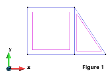

1. The whole model is shown in Figure 1.

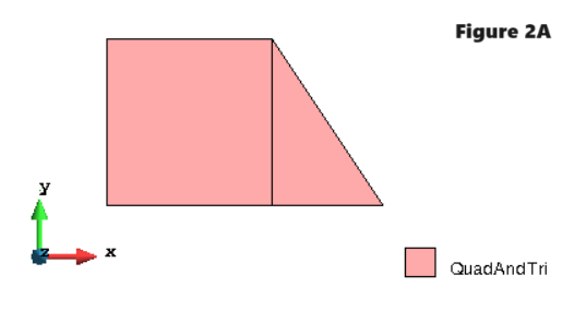

2. The QuadAndTri group contains 2 surefaces. See figure 2A.

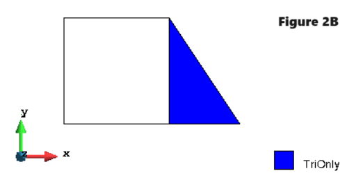

3. The TriOnly group contains 1 surface; See figure 2B. The triangle face is intentionally included in 2 groups.

Figure 1
Figure 1
Figure 2A
Figure 2A
Figure 2B
Figure 2B

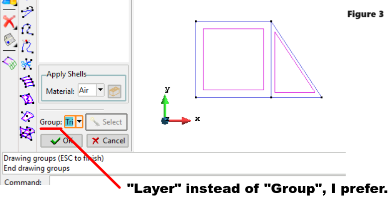

In order to avoid such problems, I think that the assignment using "layer" solves this problem.
See the figure 3.
Figure 3
Figure 3

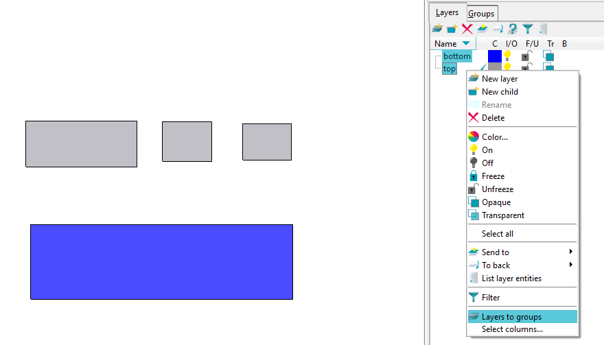

Posts: 1961
Re: Duplicate elements with the same element identification number generated.
This feature already exists
in the layer window select the layers you want to create groups, and in the contextual menu select "Layers to groups"
(and in the groups tab there is the opposite, create layers from groups)
but take into account that are not the same kind of structure, the relation is not 1-1 always
Layers are generally used to facilitate the CAD edition of geometry, selection (e.g. to assign groups or other uses)
Groups are generally used to attach to the final geometry/mesh simulation data
