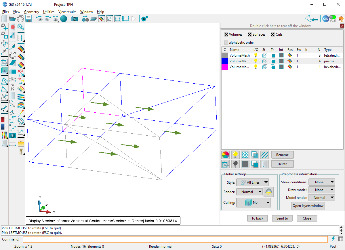

and a picture with the vectors on all elements simultaneously, because is a single result name

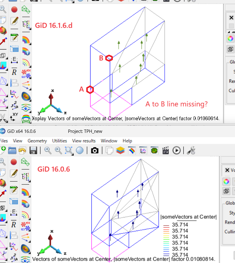

Thanks for the nice reply. But I encountered another problem.
When drawn using GiD16.1.6d, some of the line segments showing
are not visible, as shown in the figure.
Re: Simultaneous element centered vector plot if different element types exist.
Thanks for the bug report.
This is a known bug of this version 16.1.6d calculating boundary meshes mixing some element types.
It is only a visualization issue.
We have been solved some time ago, but the version 16.1.7d is already not published.
