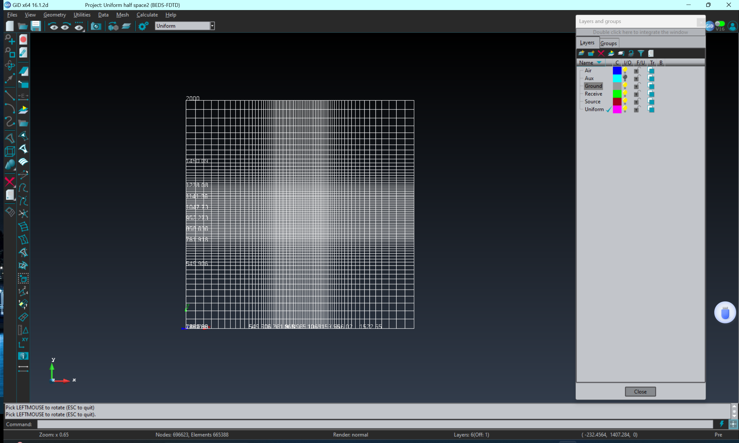

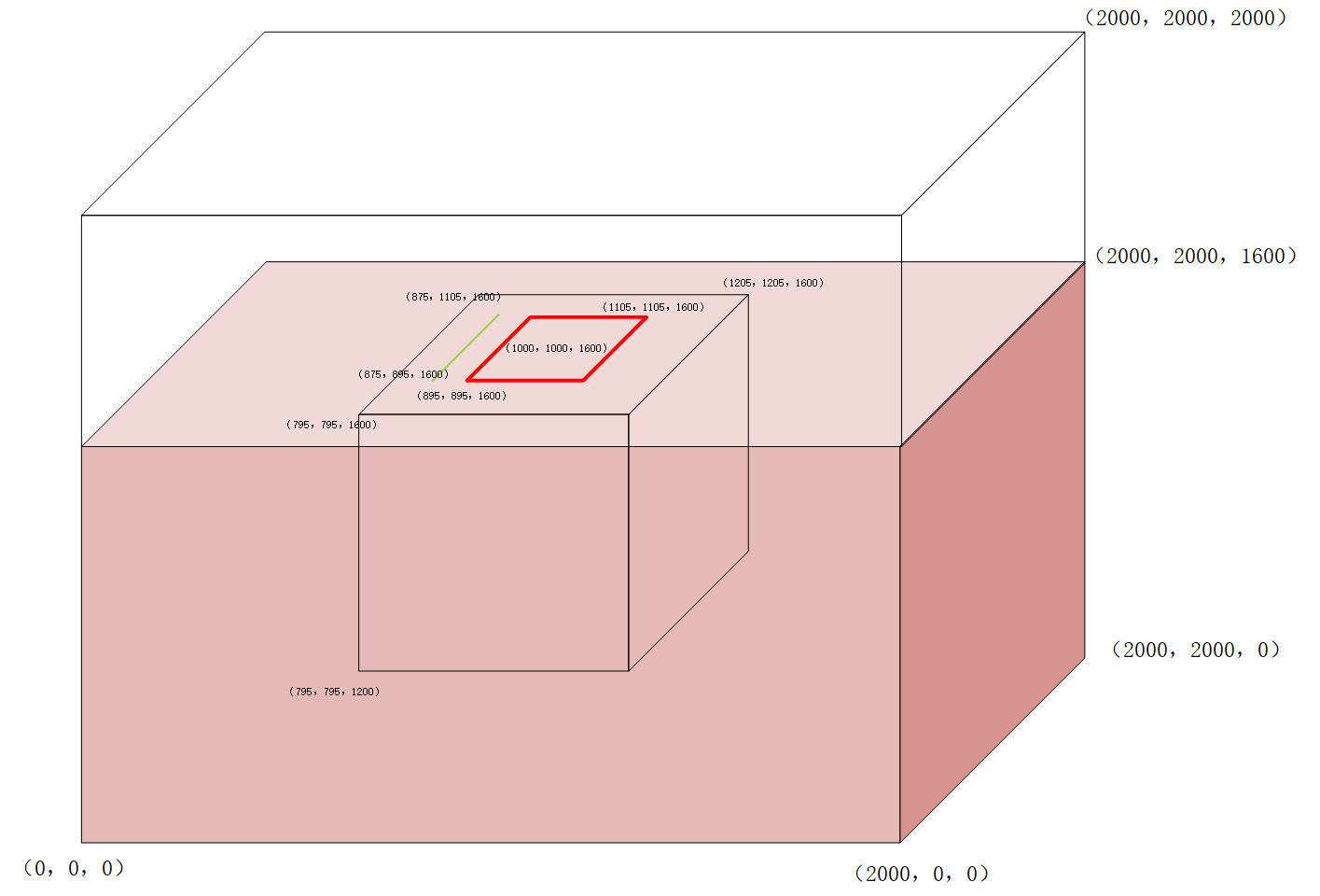

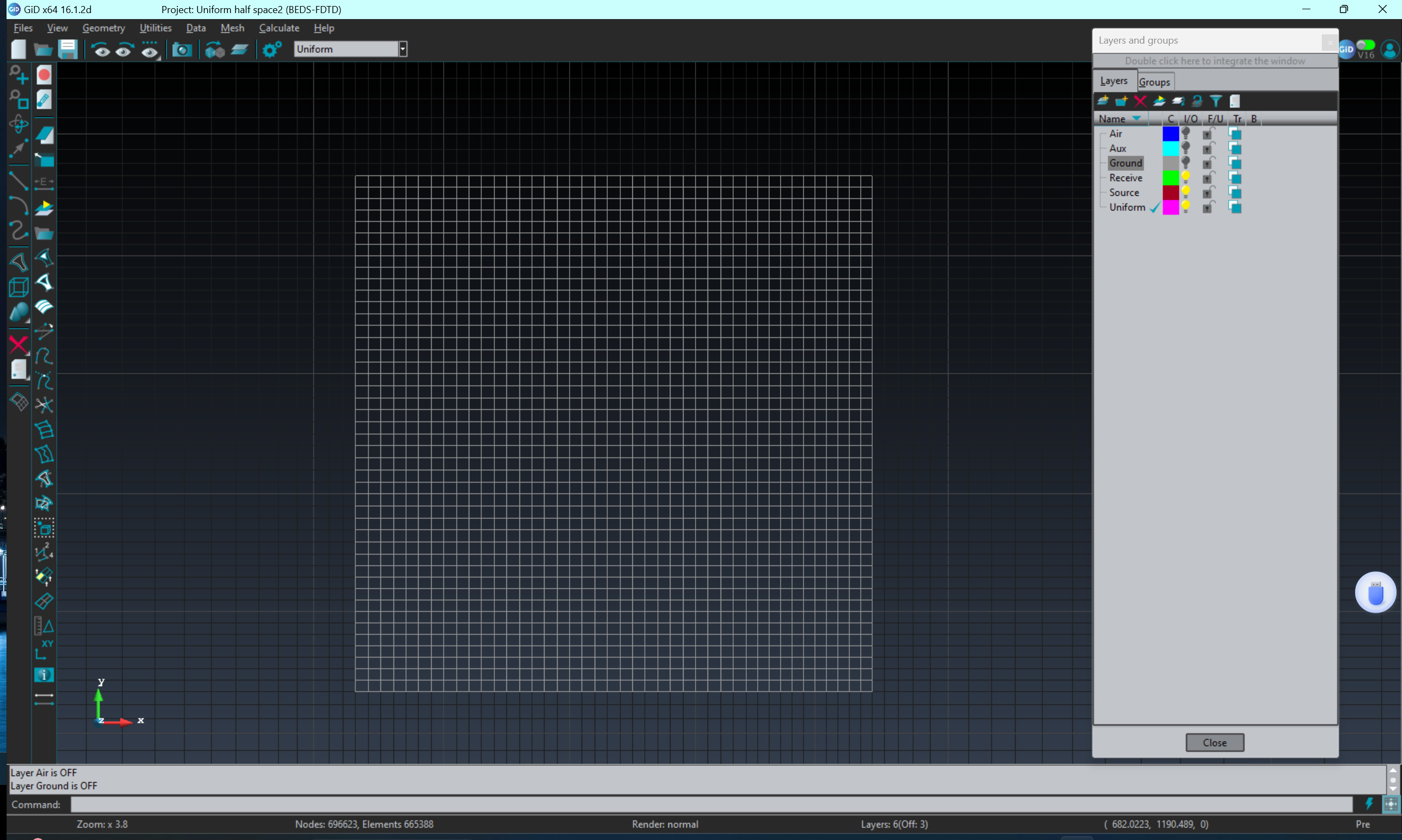

Recently, I got the model with structure grid in Zmesher. The grid size need to grow from center of model, however, requirement must keep uniform size in specified domain. For example, the whole model size is 2000*2000*2000 and the core-part size is 410*410*400, which grid size is 100 and 10 respectively. I know the Preferences Window→Meshing→Cartesian→Variable need be assigned. Minimum size is 10 and Size ratio is 1.1. It clearly 41*41 grids will be met in XOY plane of the core-part, but I got the 42*44 grids. I notice the size is not 10 in individual grids in this part. I have no idea how to solve this problem.
