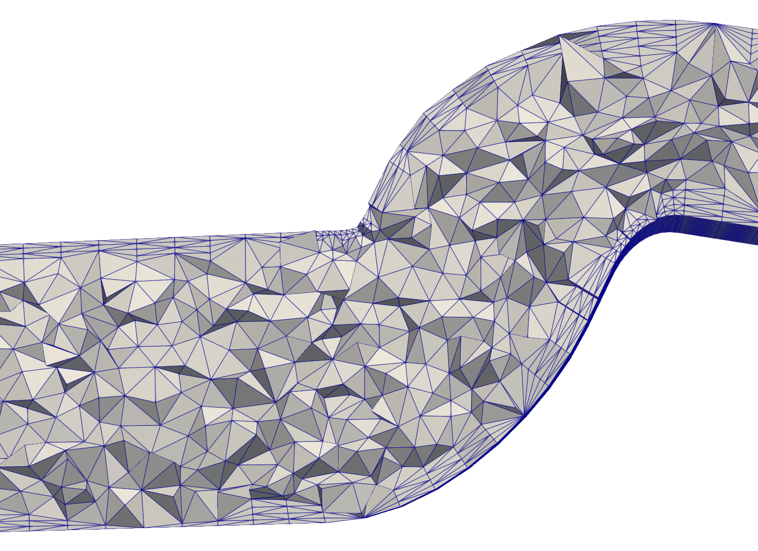

I have the CAD of an S-Bend. What I would like to do is to generate an unstructured mesh of tetrahedra, stretched in the direction of the flow.
To my understanding, GiD only allows to set a size for unstructured volume meshes. Therefore my question is: am I missing some option that would allow me to generate an anisotropic unstructured grid?

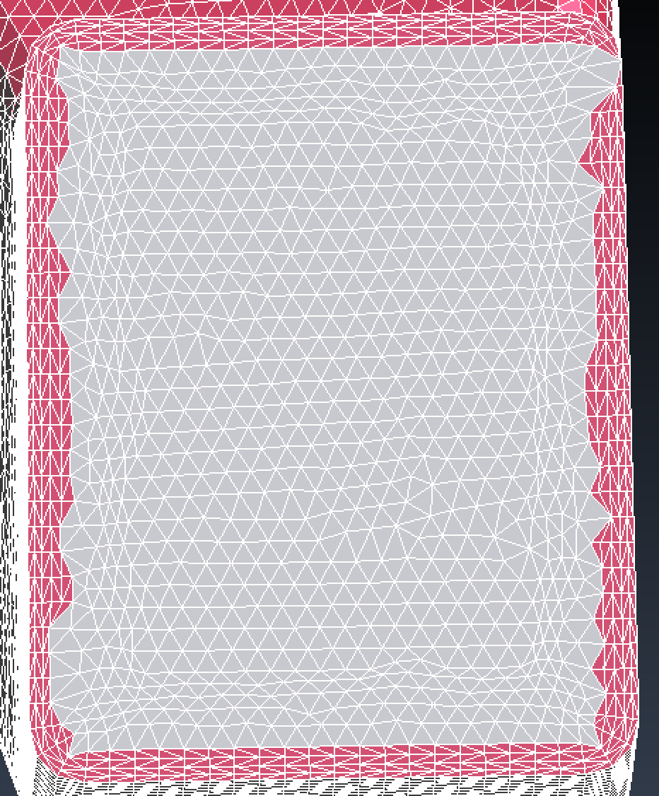

Also, I'm having issues with the 3D boundary layer function.
In the example below I've asked for a 10 elements boundary layer. However, as you can see, in most of the areas it puts less elements and there are zones in which it puts none.
Do you have any idea on what I might be doing wrong?

GiD do no only allows to set a size for unstructured volume meshes,
also structured and semi-structured meshes take have size:
Setting the number of divisions means also a kind of size
(and is also allows to assign a size that is mapped to a number of structured divisions)
if do you want attach a zip with your GiD model.
About the boundary layer, the 'number of boundary layers' is only a maximum, when the growing size of the boundary layer reach the inner unstructured mesh size the boundary layer vanish and is merged with the unstructured mesh.
Probably the thickness of your boundary mesh is too big. Usually is a very small value to try to capture the physics of the fluid touching the boundary.

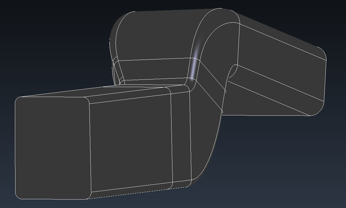

As for the volume mesh, as you can see from the project, I was able to generate structured surface meshed for the straight parts of the pipe, but I'm not able to maintain this stretching in the volume mesh...
I know that I'm probably not using GiD properly, but I'm not able to find a solution in the reference manual.

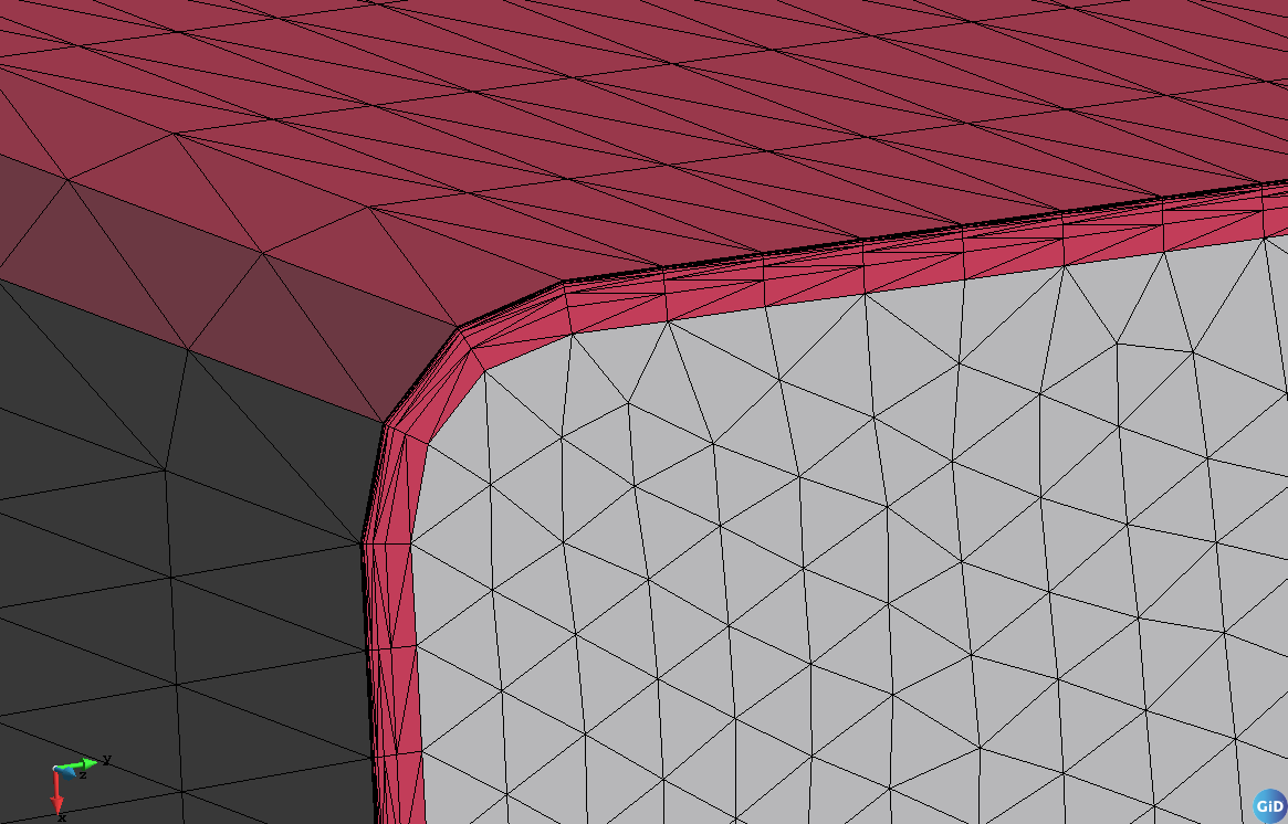

Re: Anisotropic unstructured mesh and 3D boundary layer
The thickness 0.5 of the first layer and the general mesh size of 2.0 are of the same order of magnitude,
The next boundary layer will reach this 2.0 size fastly, and will vanish mixed with the unstructured elements.
If I set for example a first thickness=0.001 this is the boundary layer obtained
In my opinion 0.5 seems a too big size for your model, but in any case I am not a CFD expert at all. You must calculate a size and number of layers appropriated for your specific simulation (fluid properties, range of velocities, Reynolds number, ...)

Also, by modifying some geometrical entities, I was able to divide the volume in 3 prismatic volumes, thus allowing for a semi-structured mesh that preserves the stretching!

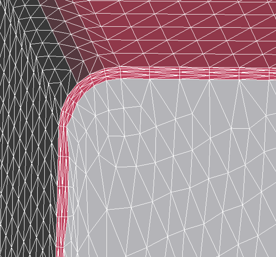

I have a follow-up question.
I've understood that, in order to properly generate a boundary layer, I have to select a sufficiently small first layer thickness.
However, at the moment I'm struggling to avoid a large jump between the end of the boundary layer and the interior mesh:
Screenshot 2023-03-15 alle 12.07.46.png (170.67 KiB) Viewed 8666 times

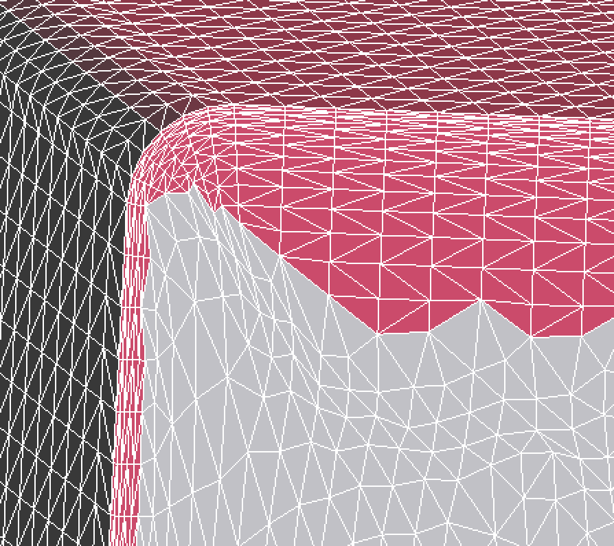

If I try asking for more boundary layer elements, it's not placing them everywhere and I still get some large jumps, especially near the corners:
Screenshot 2023-03-15 alle 12.05.02.png (129.02 KiB) Viewed 8666 times
Is there a way to fix this?
You can set a smaller mesh size transition, but this basically affects the 'normal mesh', not the boundary layer elements generation.
Utilities->Preferences->General: Size transition, set a small value (e.g. 0.1) to grown from small to big sizes more slowly.
Afthe the mesh generation there are automatically done some 'postprocess' operations, to enhance a little the mesh quality (smoothing, swap edges,..)
You can invoke again manually on the current mesh, but won't change drastically.
Mesh->Edit mesh->Smooth elements
then in the contextual menu of the mouse will appear some sub-options, can try the 'Laplace smooth' one, and select the elements to be smoothed
(and maybe is better to send before the elements to the same layer, otherwise I think that the nodes on the interface of layers won't be allowed to be moved by the smoother)
