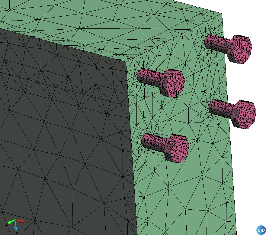

Re: connection 3D steel bar to a solid concrete block
It is confirmed by the attached model that you are using the "Atena/Static" problemtype
Your model has some volumes of the concrete of the beam and some other volumes of the steel bars.
Geometrically the volumes of your bars are overlapped with the beams, are not intersected and there are no holes in the beam volumes.
Please ask Atena, I never calculated with this problemtype.
I guess some possibilities, depending on the available features of Atena that I unknown.
1) maybe the easier approach is to replace the volumes of the bars with simple lines of its axis, that are also overlapped. I think that Atena can deal with it, and define the reinforced bars in this way (volume elements for the concrete and overlapped line elements for the bars, not sharing the nodes of the volume)
2) other approach is to do the boolean operations to intersect the volumes of the bars with the volumes of the beams, and then could have two more possibilities
2-A) single surfaces shared by the volumes of bars and concrete, with the same displacement for its shared nodes
My model_intersected.gid.zip
(3.95 MiB) Downloaded 751 times
2-B) bars and concrete volumes each one with its own surface not shared, and the the calculation must take into account this frictional contact, and must assign some problemtype specific conditions to simulate this contact, and probably do something special with the mesh.
I have attached your model, modified to be like the 2-A) case, including a coarse mesh.
My model_intersected_coarse_mesh.png (64.12 KiB) Viewed 28301 times
No, my solution that i called '2A' do not use any kind of 'contact'.
Simply I've made that the mesh is continuous between the elements of material 'concrete' and the elements of material 'steel'. The elements are sharing the nodes (because I have created shared surfaces between the geometrical volumes, and the mesh inherit this topology)
It will act numerically like there is glue between the steel and the concrete.
The node is unique, then its main unknown that is the displacement in the FEM simulation F=K*d is the same for both parts.
For other kind of simulations that try to represent a contact with possible relative movement between the parts in contact, must read the ATENA manuals to know how must be defined.
Please ask it to ATENA developers, this forum is for GiD questions (geometry, mesh, postprocessing, customization,...), not for third part problemtype questions.
I have created a video with my operations to have a geometry well connected, without overlapped volumes.
https://youtu.be/vMb_Rc2h_p0
Basically
1-I have used the boolean operation of "substract and intersect", the result is (A-B) + (A Intersection B)
2-I have re-build the missing part of the bars, creating a cylindric volume by extrusion of a surface with translation.
3-I have used another boolean operation of 'union' to merge the cylinders and the head of the bars
4-Finally I have assigned mesh sizes to the curves, surfaces and volumes of the bars, and left the rest with a general mesh size
5-Before generate the mesh, I've set 8 threads to mesh faster, and used the 'Tetgen' option for volume mesher (this generate the mesh with a Delaunay method, that usualy is fast and robust)
