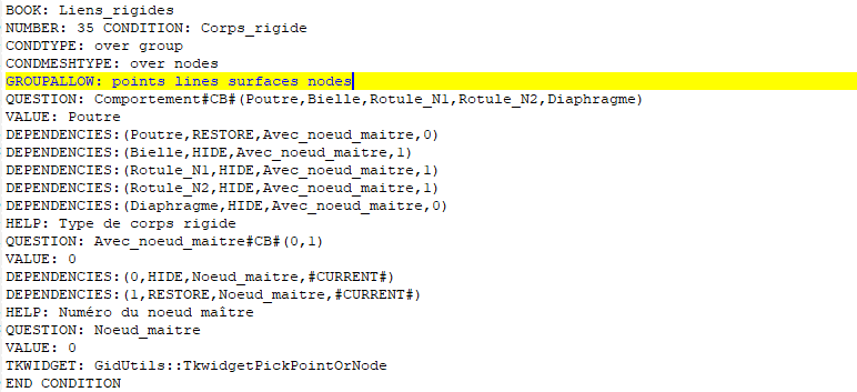

I want to create a new condition with these parameters :
[*] CONDTYPE: over groups
[*] CONDMESHTYPE: over nodes
[*] GROUPALLOW: points lines surfaces nodes
So the condition should be applied to a group that can contain only points, lines, surfaces and/or nodes. So far, everything is fine except that when I open the condition data window for this condition, I can select points, lines, surfaces and also volumes although it's not allowed (cf. print-screen 1).
However, if I apply another condition from another book on any entity and then open again the condition data window for this new condition, I can select only points, lines and surfaces, which is what I want (cf. print-screen 2).
Do you have any idea why the condition data window behaves like this?
So the condition should be applied to a group that can contain only points, lines, surfaces and/or nodes. So far, everything is fine except that when I open the condition data window for this condition, I can select points, lines, surfaces and also volumes although it's not allowed (cf. print-screen 1). However, if I apply another condition from another book on any entity and then open again the condition data window for this new condition, I can select only points, lines and surfaces, which is what I want (cf. print-screen 2). Do you have any idea why the condition data window behaves like this?
(We are using GiD v14.0.)
Thanks!
