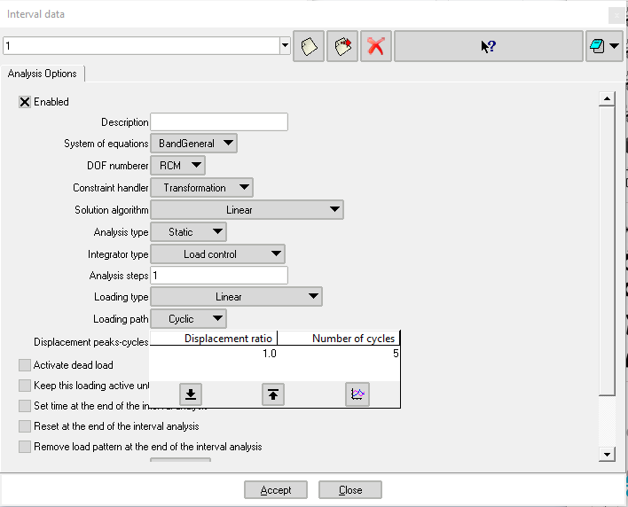

I have verified it opening with a text editor the file <modelname>.prb
and also opening in GiD the "Interval data" window, like the image
Please, let me know if I' am missing something to repeat the bug
