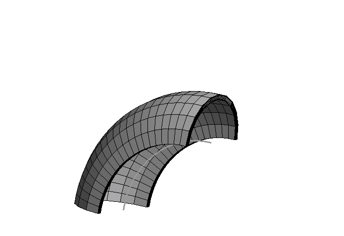

Is it possible to mesh this part ONLY with hexahedra elements? I assigned the element type hexahedra, but GiD generates linear elements, too.
- Posts: 8
- Joined: Sun Nov 19, 2017 4:23 pm
Re: Cylinder
I've managed it. The problem was that I didn't erase the line that served for sweep operation and GiD automatically added linear elements to that line. Sorry for disturbing
