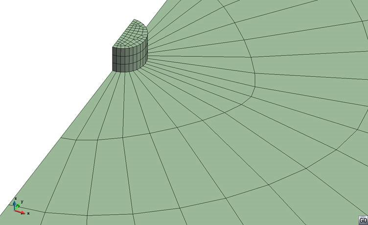

As I explained by e-mail the model is corrupted because of a degeneracy of the geometry on the revolution axis, specially after collapse very close points.
The best approach is to not use a structured mesh in the volumes touching the revolution axis, because of this degeneracy.
In your case is possible to use a semi-structured mesh to be able to have hexahedra also in these volumes (the rest of volume rings could be fully structured)
semi-structured and structured hexahedra.png (203.48 KiB) Viewed 6289 times
