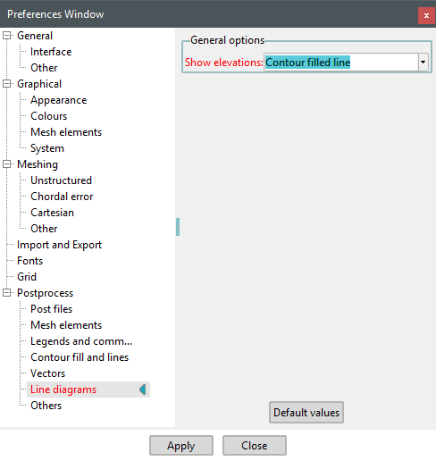

There is a preference to do it.
You must go to Utilities->Preferences...
Postprocess->Line diagram and set 'Show elevations' to 'Contour filled line'

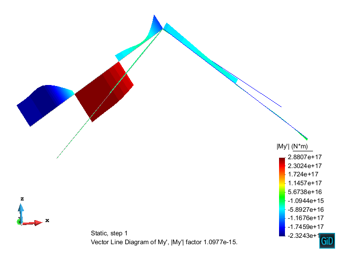

This is an example of the bending effort on a structure of four beams.
