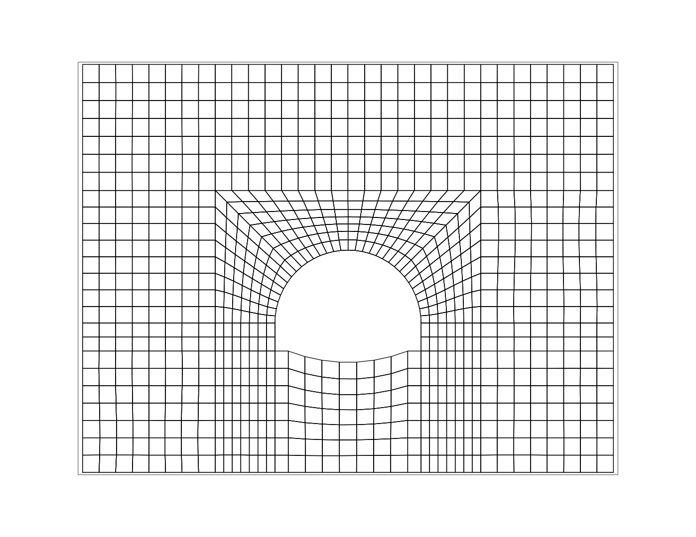

What I want is a drawing with the mesh such as the attached, but with numbers on each element and node, such that I can identify the nodes and elements visually in the drawing, very much like the feature of displaying the labels on GiD, but hopefully with more control over the label's text size.
Is this possible? either directly from GiD, or using e.g. AutoCAD.

In GiD, you can try to change the font used for these labels in Utilities->Preferences... Fonts
Labels of nodes and elemenst on preprocess are controled by the "Fixed width bitmap font" of preferences, buy I think that this only is implemented on the current developer version e.g. 12.1.10d, not in official versions
In postprocess nodes and element labels are working in a different way than in preprocess, the use the "Labels" true-type font of the preferences window.
With AutoCAD you won't be able to preserve the GiD node or element ids, because there is not a one-to-one relationship with DXF/AutoCAD entities, there is a translation to 'somehow similar' entities.
