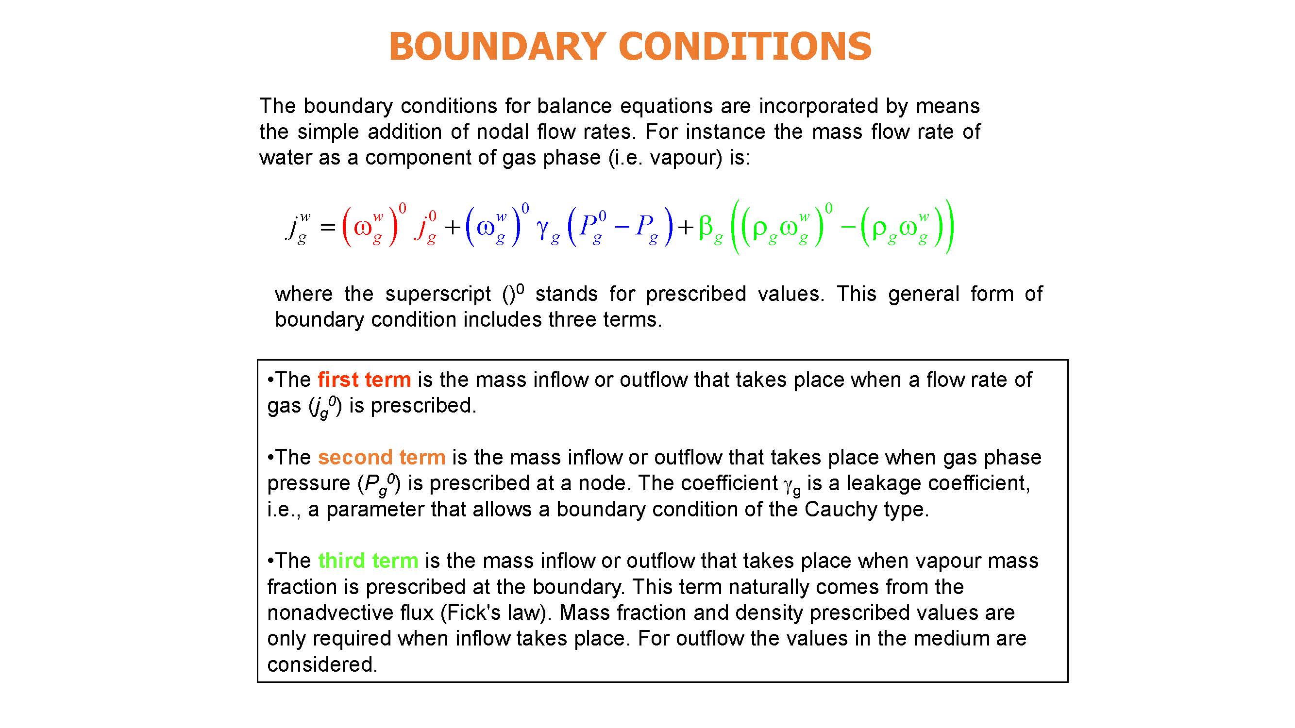

My question is related to the CO2 properties given in case of injection. The carbon dioxide properties are given at the flux bc in terms of gamma for gas. What exactly is this gamma? I guess it is not specific heat ratio as its value is 1000 in some cases in the tutorial problems. Also how does CO2 differ from air in terms of the input values for gas?

Please find attached a brief explanation for the gamma for gas.
- Gamma for gas_Página_2.jpg (118.58 KiB) Viewed 15226 times
- Gamma for gas_Página_1.jpg (295.82 KiB) Viewed 15226 times

Thank you for the explanation of gamma. But how does one change the carbon dioxide properties? Lets say that I wish to inject any other gas like methane or change the state of CO2 from supercritical to gaseous and vice versa. What input parameters determine this change?
