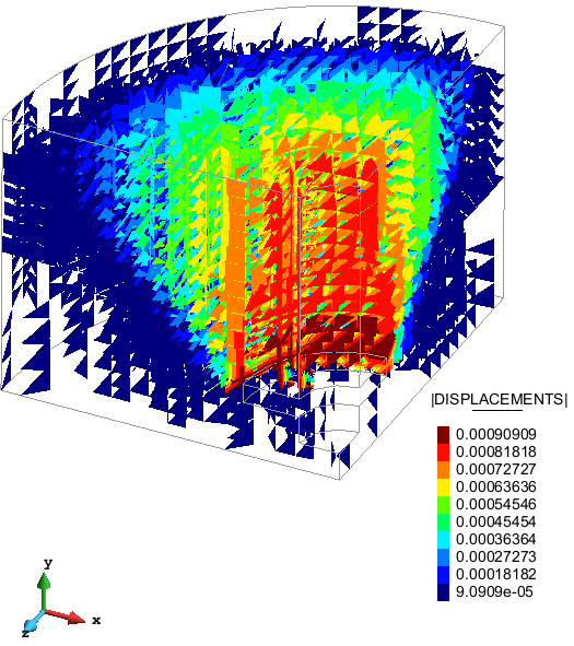

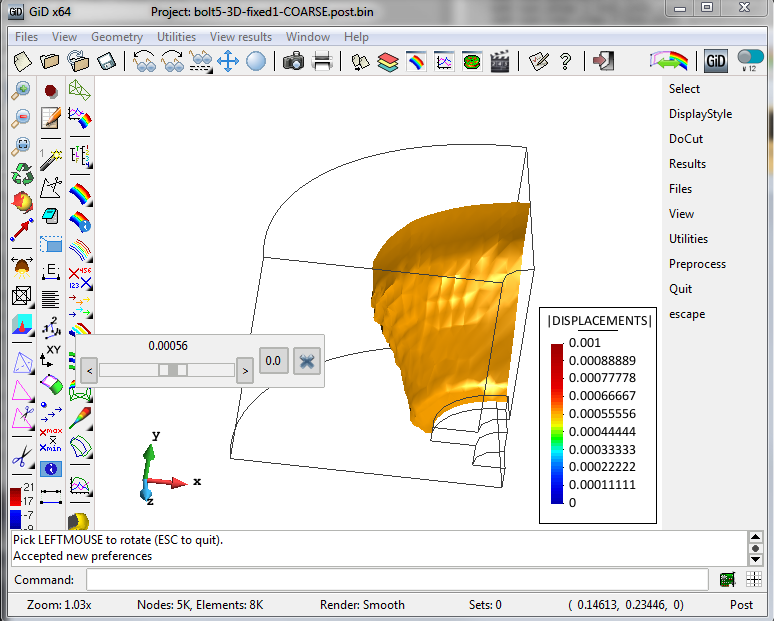

I would like to plot isosurfaces on prismatic 3D elements. However the plots are fragmented as in the attached photos...

- Isosurface with GiD12.1.8d
- Captura.PNG (90.1 KiB) Viewed 8447 times
- Isosurface with GiD12.0.8
- Captura2.PNG (63.22 KiB) Viewed 8447 times

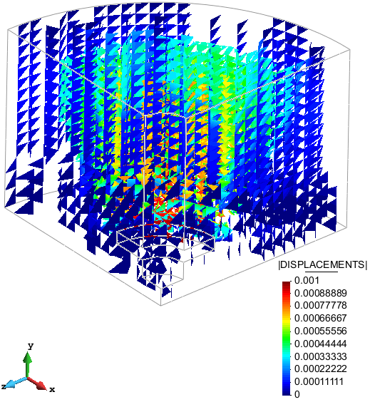

- borrar.png (130.98 KiB) Viewed 8430 times
