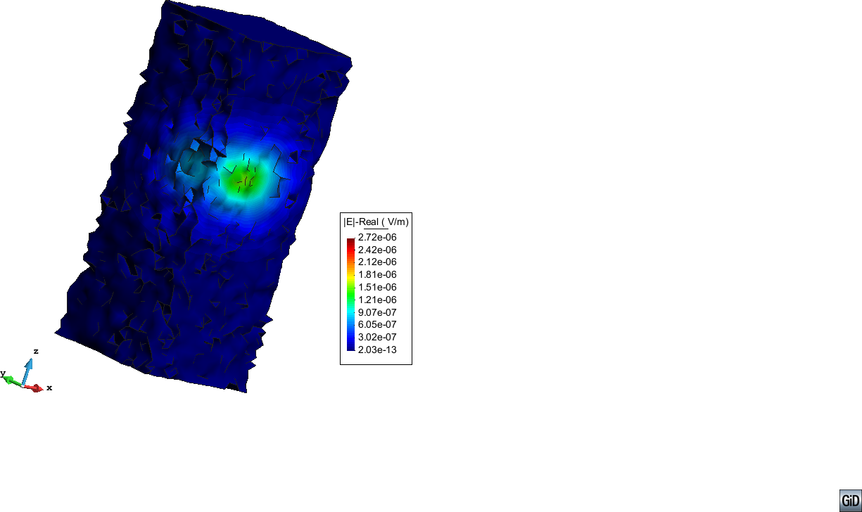

This pictrue is an example for the second question . As you see,the surfacce of the volume cut is uneven,how can i make it even? Because the original model is too big to show the interior.

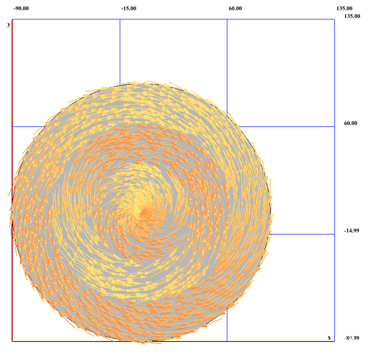

This pictrue is an example for the first question .As you see,the picture is a cut of 3D volume.But the axes frame are not fit it.How can i change the length of axes?

- This pictrue is an example for the first question .As you see,the picture is
length of axes? - 2nd.png (257.44 KiB) Viewed 14880 times
- This pictrue is an example for the second question . As you see,the surfacce
model is too big to show the interior - 1st.png (219.61 KiB) Viewed 14880 times

in regard to your second question "2.when i cut volume ,it produces a new 3D geometry but not smooth and always irregularity .it dosen't like the cut plane and cut sphere.But i want a new 3D smooth cut ."
How do you create this cut ( Do Cut --> Cut plane) ? or Do Cut --> Cut Sphere ?
Can you post the example somewhere i can download it?
Are you using quadratic tetrahedrons?
If you are using Do cuts --> Divide volume sets, then the tetrahedrons are not actually cut. Full tetrahedrons are 'selected' and sent to a new mesh.
In future we'll add an 'exact' option to cut the tetrahedrons and create a mesh of partial tetrahedrons.
Do Cut --> Cut plane / Cut sphere cut the tetrahedrons using a plane / sphere-shell, and create a triangle mesh over the plane/sphere-shell.

About your first question, is not possible to set the size of the axes. But we will take in account your problem for next improvements.
