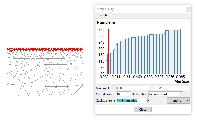

How to get the minimum size(length) of an element in the GUI?
Is it possible to output the smallest element size(length) by writing a .bas file, or even operate on it?
Thank you!
Re: How to Create a GiD Problem Type
You can use the 'Mesh->Mesh quality' tool, selecting as quality criteria 'Minimum edge'
Can see a frequency graph or and accumulated frequency graph (default)
Clicking the graph they are selected the elements under this x-value
The data to populate this graph is obtained with the 'GiD_Info MeshQuality' GiD-Tcl command
https://gidsimulation.atlassian.net/wik ... eshquality
From the .bas can invoke a *tcl command to print the value of minimum edge of the whole mesh of triangles with something like this:
minimum triangles edge=*tcl(lindex [GiD_Info MeshQuality ElemMinEdge Triangle 0 0 1] 1)
Off course yourself can calculate the distance between the node's coordinates of an element (can ask GiD for the nodes of an element and ask for its coordinates with Tcl commands)
