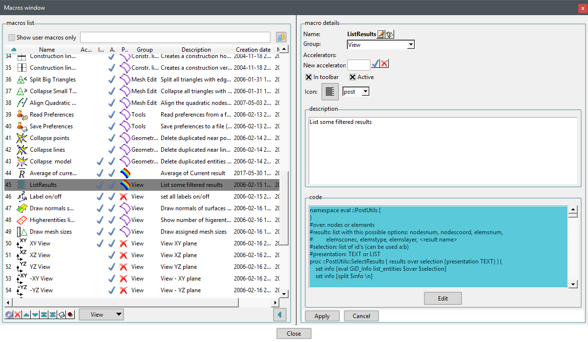

And about the 'Select Results window'. It is showing just what do you want to get in Tcl, it is not?
The Tcl code of this window is implemented as a macro, that is pure Tcl scripting.
You can see the Tcl code of the macro as an example.
Click the second button of the 'macros toolbar', and in the macros window select the icon of 'ListResults' and you can see the Tcl code that is invoking

About the 'ListResult'... I didn't realize that it was a macro! I just saw it. Actually what I wanted to get are the results (in a list to process them), not the window, but if I cannot extract those data from the 'GiD_Mesh -post' command, I'll try this way.

all buttons of the 'macros toolbar' are macros that could be customized (could show/hide them and define new macros that are Tcl procedures)
About getting results, the 'GiD_Info mesh' GiD-Tcl command wont't be enough, you must use more commands, like 'GiD_Result'
Have a look to the available GiD-Tcl extra commands in Help->Customization manual->Tcl and Tk extension
And have a look to the related code of the 'ListResults' macro, It finally show the results in a window, but the data to fill the window is obtained with Tcl procedures (without any window)
