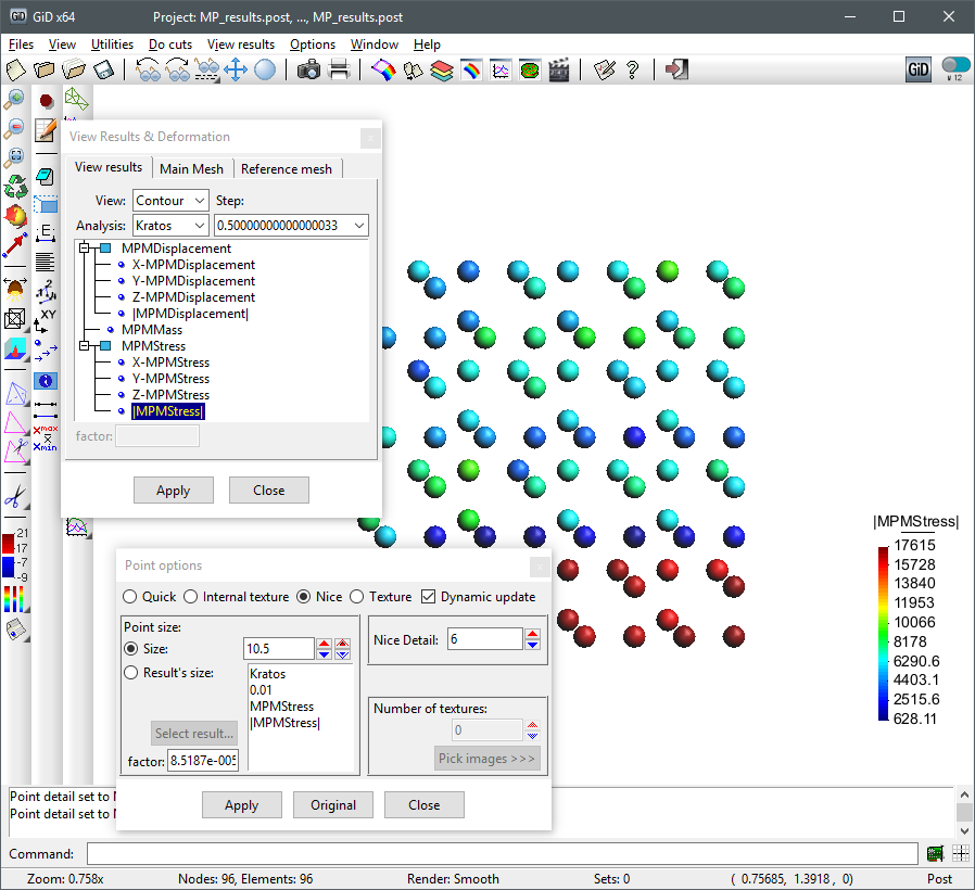

Posts: 1961
Re: MPM_can't visualize results of particles
First suggestion: instead of provide different prefix names to the .post.msh and .post.res files, and then have to do two steps to be read (read the mesh and the merge the results file) why not use the same name, and then must only read it (selecting one of the the other is implicitly selected by its name)
And also better, if do you have also a .gid folder model, using the same model name the .post.msh is uneeded (the mesh of preprocess is used) and when changing from pre to post the results are automatically read, it is not necessary to explicitly open/import them in postprocess.
About showing results, I am able for example to show (GiD 12.0.11) this contour fill of the modulus of the vector result MPMStress
you can see that I have set a a big point size to appreciate the result.
GiD 12.x: Options->Geometry->Point options...
GiD 13.x: Utilities->Preferences... Postprocess->Mesh elements- point element options
and this animated gid of a deformed result
Window->View results - Main mesh - Deformed (and select a vector result), and Window->Animate... to do and save the animation along the time steps
