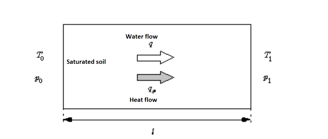

I'm new with GiD and I need some help please.
I attached a problem I have to solve in this topic.
To solve it, I imposed initial unknown temperatures on both left and right sides of my geometry (20°C and 10°C respectively), initial unknown pressure on the right side (0.1 MPa), and a flux B.C on the left side with a prescribed pressure (0.2 MPa with an increment of 0.01).
I set the material conditions so as to make it a rockfill, with mass balance of water and energy balance equations to solve.
But I get the error message "Erroneous node numeration, mbndg > numnu". What does it mean and what should I do?
