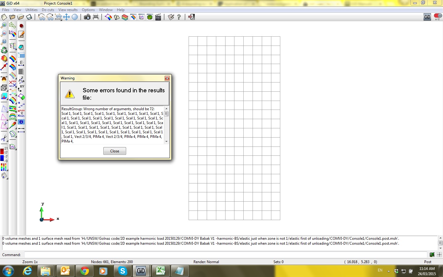

I wrote a Finite Element program in Fortran and I want to see the results of gauss points in GID. I made the MSH file (.msh) and RES file (.res) the same as the formats in the Customization Manual. I can simply open the .msh file and I can see the mesh. However, I get an error about the res. file (please see the picture attached).
I want to see the results of 71 parameters; hence my .res text file has 71 columns in the values part. The error says that I should have 72 arguments. I thought that may be I should add another column containing the number of nodes in it. But it did not work. I got another error which said that now I should have 71 arguments!

The results format it's not correct.
You only have to put the number of the element once and then all the results values, in this case for each Gauss point. You don't have to include the number of the Gauss point.

Dear Anna,
Thanks ever so much for your guidance.
I amended the results file and the problem was fixed.
