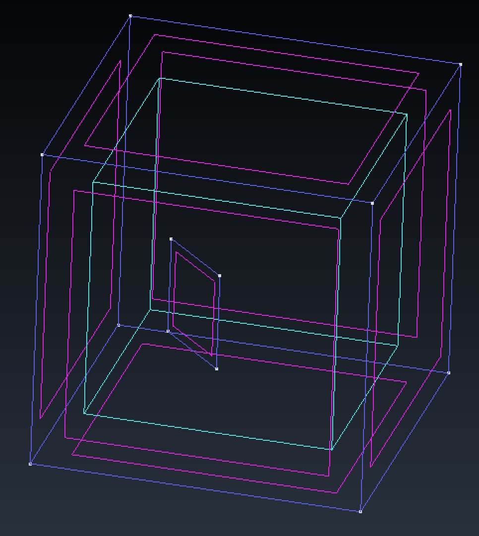

Dear GiD team,
I'm trying to create a mesh for the rock volume that contains a small fault.
For example, if I define the rock with a single volume element and the fault with a single surface element (that is located inside the rock), how can I create a 2D triangle and 3D tetrahedral elements for the fault and rock, respectively?
Attached is an example GiD file.
I would really appreciate If you can give me some comment or tip on this question.
Kindly Regards,
Kenji Furui
Waseda University
earthquake.gid.zip
(15.24 KiB) Downloaded 410 times

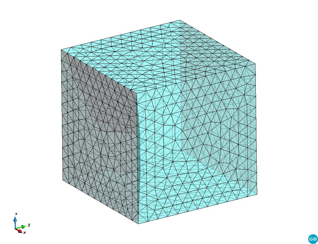

In your case it is necessary that the surface is boundary of the volume. Can create extra surfaces to split the volume in tho volumes, with the surface of interest as part of the splitting surfaces.
In your simply model it is easy to do:
but in a general model could be too difficult
I attach my GiD model splitted and with the kind of mesh that you want:
earthquake_split_2_volumes.gid.zip
