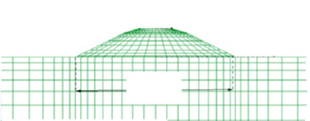

i have an other problem with different mesh size.
I try to create a quadrilateral mesh for a fill section on a foundation with different size (small size at the middle, under the fill and big size outside of the fill).
I can't find the correct way to have a good quadrilateral meshing. I don't know if the best way to do that is to create many section element?
this picture to show what i'm looking for and this picture to show the different section element i created to try to have the meshing presented before thanks

Creating several surface do you have more control of the final mesh.
In your example, you can do a structured mesh of quadrilaterals, because all surfaces are 4-sided (a topological square)
Mesh->Structured->Surfaces->Assign number of divisions to surface lines
and you must set amount of divisions on each one of the two directions
You can also force the concentration of elements near the start or end of the lines with
Mesh->Structured->Lines->Concentrate elements
Select the lines (know the advancing direction is crucial) and set weights to the start or end. A positive weight attract the elements, a negative value repulse the elements (but the amount of elements is fixed in this case by your structured surface divisions).
e.g. negative weights at start and end will concentrate elements in the middle of the line.
