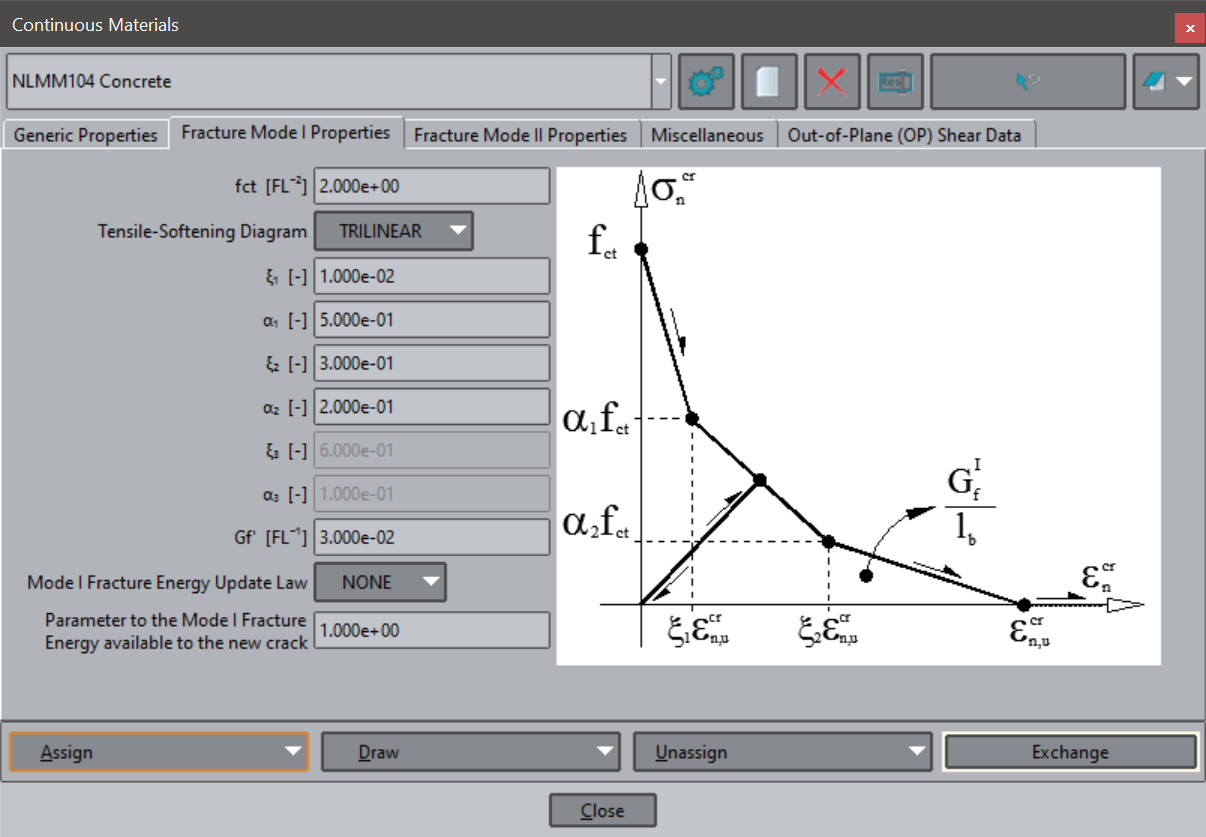

Guys,
In our classic problem type we have images to illustrate the meaning of the variables, as you can see in the image below.
I am now rewriting our problem type using the new system (based in the CustomLIB library). I suppose it is not possible to add images to the tree, so what do you suggest? What is the best way to convert this old dialgo to the new problem type system?
As far as I know using the tree is not possible to add images.

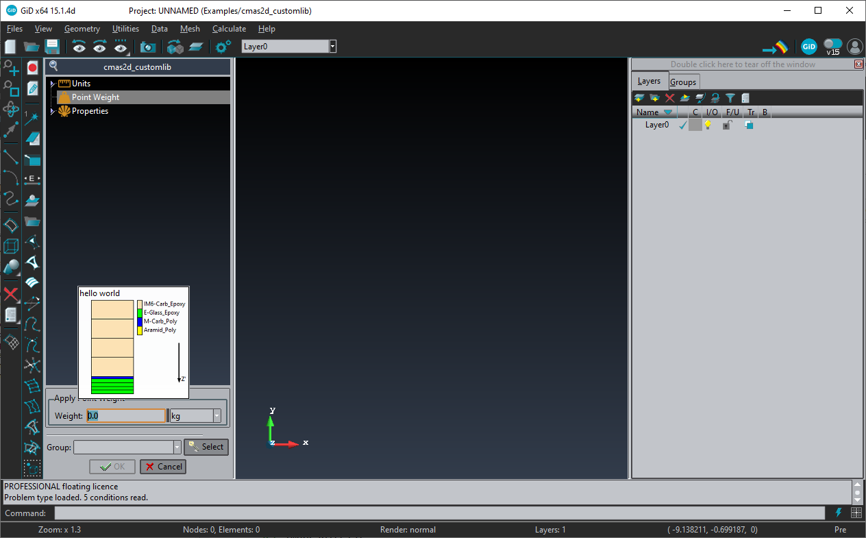

Posts: 1961
Re: Images
There is a more simple option,
copy the image to a folder named images inside the problemtype
and add to the .spd the attribute
help_image="your_filename"
e.g.
then the image will appear below the contextual help text, like this
