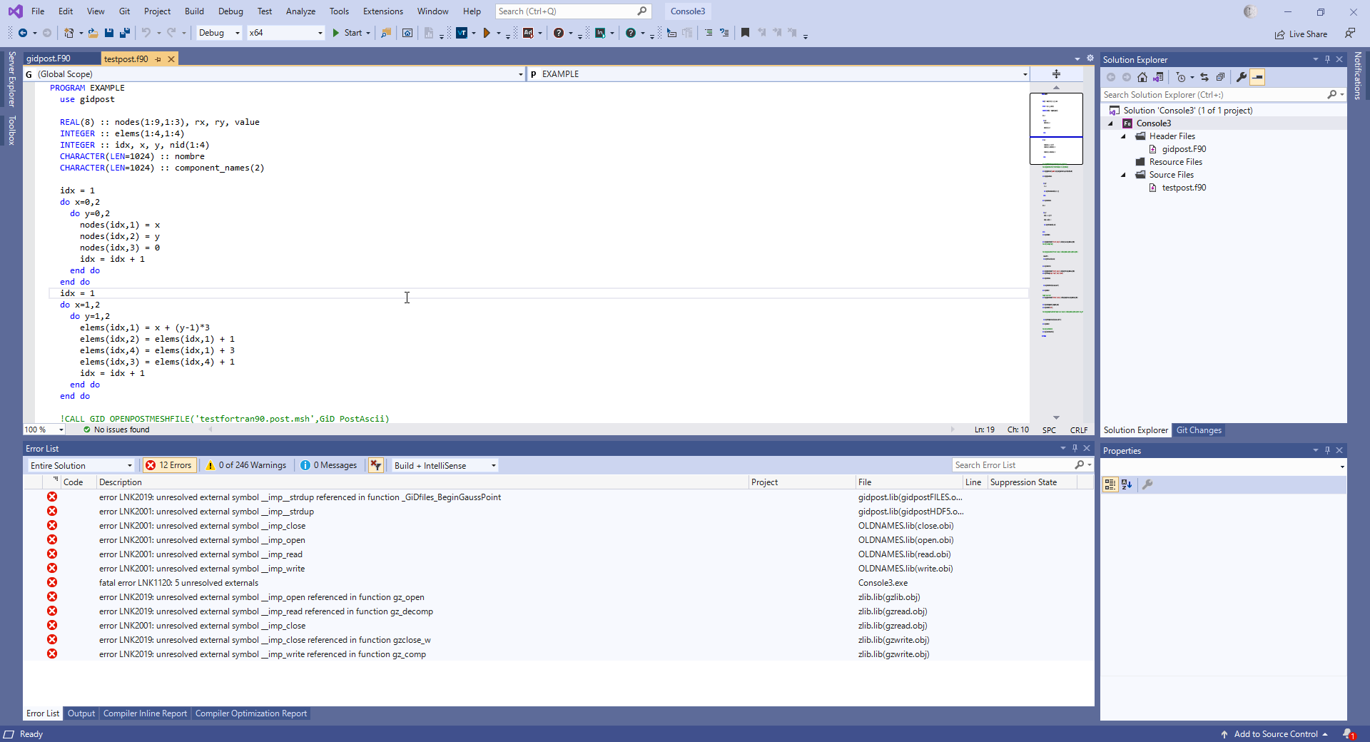

I'm trying to use gidpost (v2.7) for my simulation model and encountering some errors as shown in the attached file.
My computing environment is:
IDE: Visual Studio Community 2019
Compiler: Intel Fortran Compiler Classic 2021.1.1
Platform: X64
For testing, I tried to run an example file (gidpost.F90). It worked just fine when running the program on Runtime Library: Debug Multithread DLL mode via Linking gidpost.lib zlib.lib hdf5.lib which are located in binaries\win\vs2017 folder.
When running the program on Runtime Library: Debug Multithreaded (or Multithreaded) mode, I got several error messages saying "unresolved external symbol" as shown in the attached file.
2021-01-06 13-25-26.png (136.73 KiB) Viewed 13920 times
Does this mean that the library files can't be statically-linked by default?
I would really appreciate if you can point me how to statically link these library files to a Fortran code or provide me static version of the library files as I'm not familiar with cMake stuff.
(My program uses the oneMKL version of Paradiso solver, which doesn't support dynamic linking on Windows...)
Thanks in advance,
Kenji

In gitpost we provide some precompiled version for Windows, compile with some VS version and some settings, but is not possible to provide all combinations
But we provide the source code of gidpost: you can recompile as you need
(static /MD, static /MT, dynamic,...), with debug symbols or release, for Windows, Linux, or other platforms,...
I am not sure if the .lib files included today in the gidpost-2.7.zip file are compiled with /MT or /MD flag
Both are static libraries, not dynamic (there is not a gidpost.dll, but is possible do it compiling a dynamic library)
/MD ==Multithread DLL mode
/MT== Multithread mode
The difference is that with /MD the exe will al depends on some MSVC runtime libraries of the VS version used to compile
We prefer the /MT do not require these extra dlls
There are required two third part libraries:
zlib.lib
hdf5.lib
Can download its source code finding in Internet, and compile as you need.
In any case, to facilitate the tast without compile all these libraries I attach this extra .rar file
gidpost2.8_vs2017_MT.rar
(2.82 MiB) Downloaded 618 times
It has the libraries compiled with VS 2017 for Windows x32 and x64 and /MT flag

Thank you so much for your prompt reply and providing the updated lib files. I was able to run the program with the updated library files successfully. :D
I guess I need to learn how to compile the source code for building library files in future.
