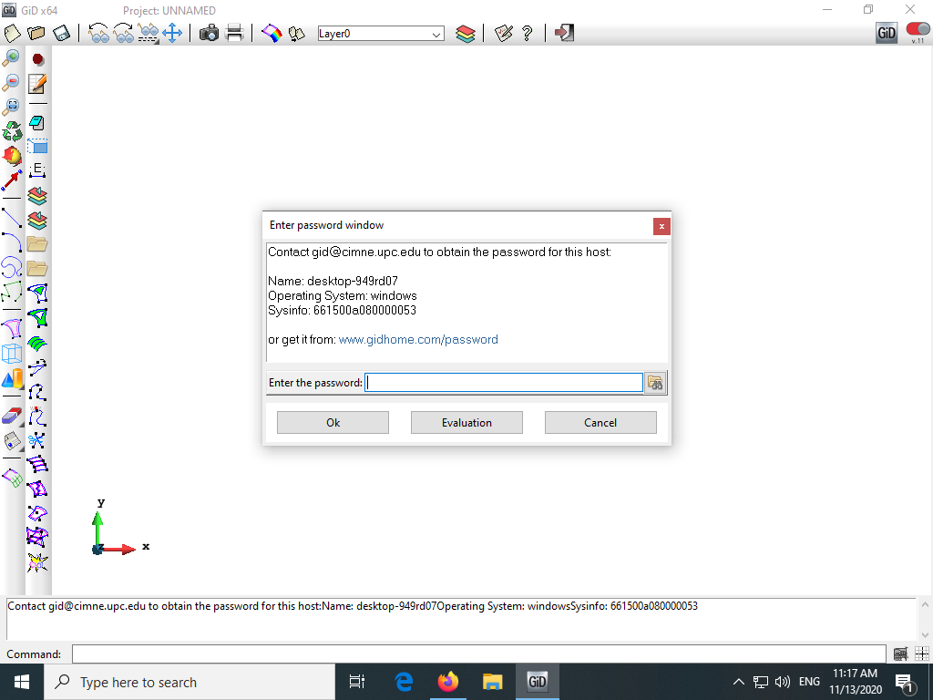

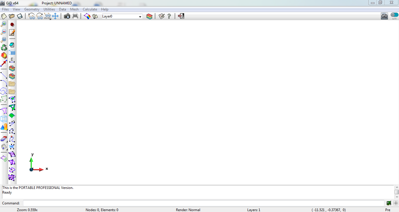

When I use the USB on windows 7 it works perfectly fine and the top right corner icon turns into blue (the professional version). However, when I use it on windows 10 it remains red (unregistered version).
GID version: 11.0.8 or 11.1.9d
Operating system: Windows 10 Pro
USB type: hp v165w Rev_1100
Graphics card: AMD Radeon HD 5450
I even tried running it with OpenGL and it didn’t work. I can provide you with the permanent license No. if need be.
I have attached the images of the GID environment both in windows 7 and 10. Many thanks for your patience and kind consideration.

- USB inserted Windows 10.PNG (86.67 KiB) Viewed 16626 times
- USB inserted Windows 7.PNG (61.85 KiB) Viewed 16626 times

Ok, Initially I understood that GiD doesn't work in your Windows 10,
not that it works but limited to academic limits, because your old password is not valid for the new operating system
Let me know the old Help->Register GiD... data showed by your GiD 11 installed in Windows 7 (or your GiD 11 licence number)
and let me know also, as text instead of as image, the new data (showed by GiD 11 installed on the new Windows 10)
Instead to put this information publicly, better send to me privately:
- in a private message of this forum (click the envelope icon located on the upper-right)
- or by standard e-mail
- or using our contact form http://www.gidhome.com/contact-us
