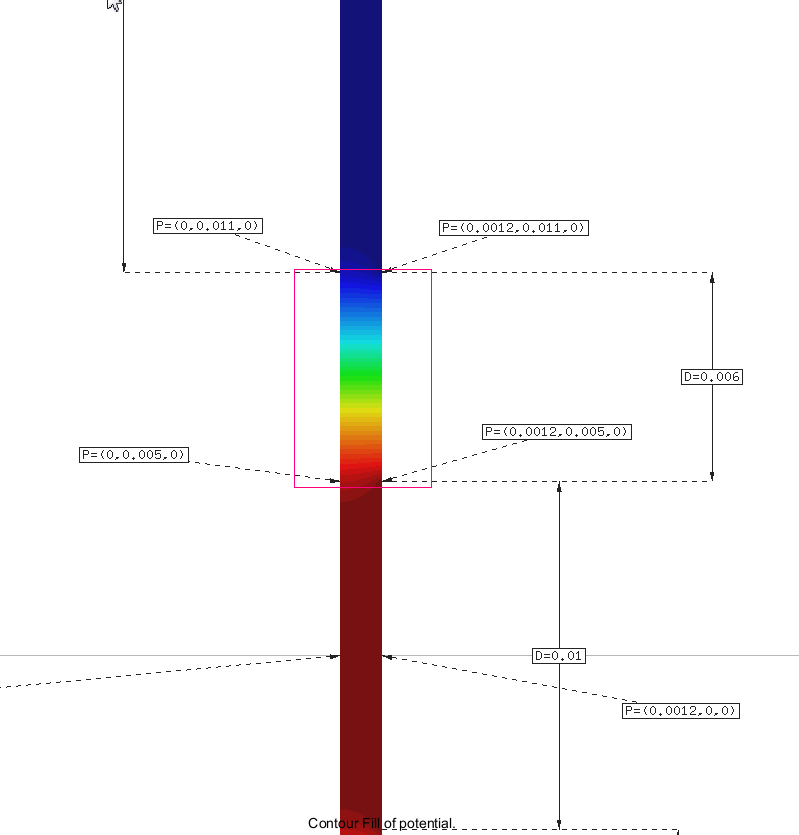

I am wondering how can I extract the raw data from a specific area (as shown in the attached image -- in the rectangular line)
Is it possible to present the data just for the specific area and import the node parameter, Ex Ey and E from that area into the new excel file?

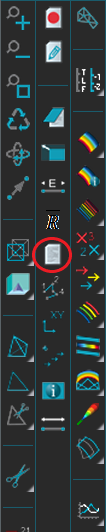

You can use the macro called "List some filtered results" that you can find in the macro's tool bar.

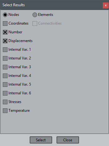

A window like this will open, so you can select what information you want to display.
Press select and define the area that you want. A text window will appear with the selected data, so you can copy that on an excel file.
