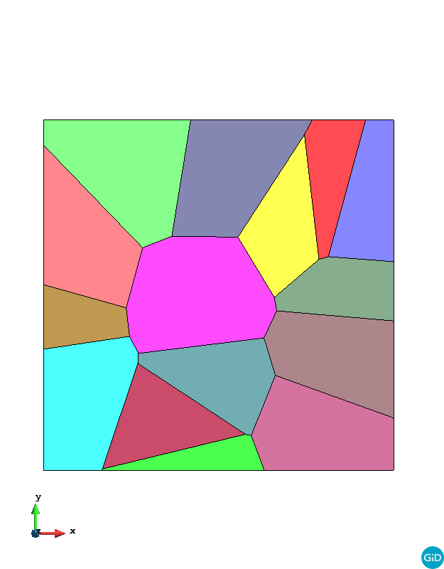

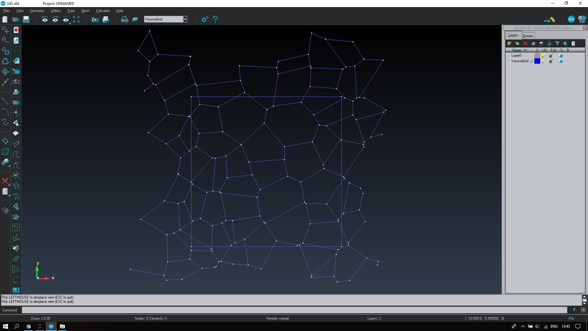

I am drawing a Voronoi grid and I would like to confine it with a square of certain dimensions that I can set. What I want to achieve (before and after) is seen in pictures 1 and 2.
Is there any way that this could be done automatically through a batch file rather doing it manually?

- picture1-before.png (162.21 KiB) Viewed 7702 times
- picture2-after.png (161.05 KiB) Viewed 7702 times

Re: how to delete all types outside a certain shape
On the other hand, about your question,
to automatize your operation probably a batch is not enough, because you don't know a priori the entities to be selected, etc.
You must do it with a Tcl procedure, with full scripting control.
In Tcl you could use GiD_Process to send GiD keywords (like the batch)
or better, instead GiD_Process using some GiD-Tcl direct commands when possible, like GiD_Geometry.
You should do the steps that you are doing manually
-create your four 'trimming lines'
-intersect lines (try selecting all against all)
-delete the unwanted lines (and dependent points), selecting the ones to be removed with some geometrical criteria (e.g. with its center outside your trimming rectangle)
