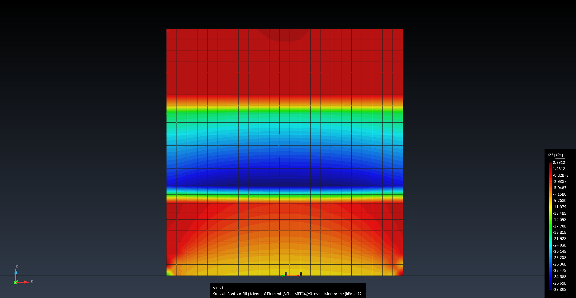

I have a simple 2D panel
which I am meshing with quadrilateral elements.
When I solve it for dead load I am getting strange results (some elements show sxx instead of syy)
because of element orientation.

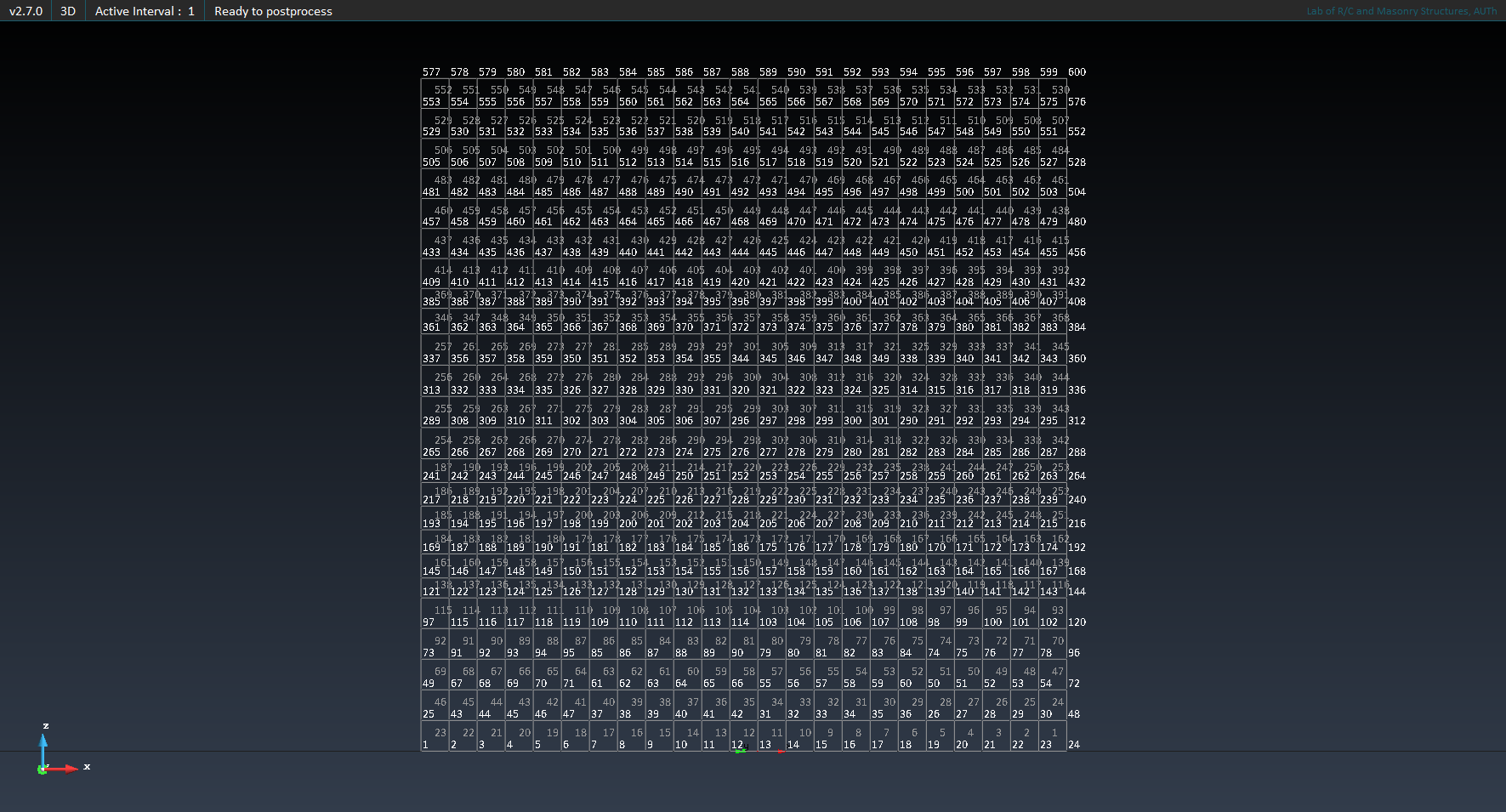

That means that node numbering for some elements start from the lower left corner and some of them from the
lower right corner. When I am showing the node numbering, there are some strange gaps in number sequence.

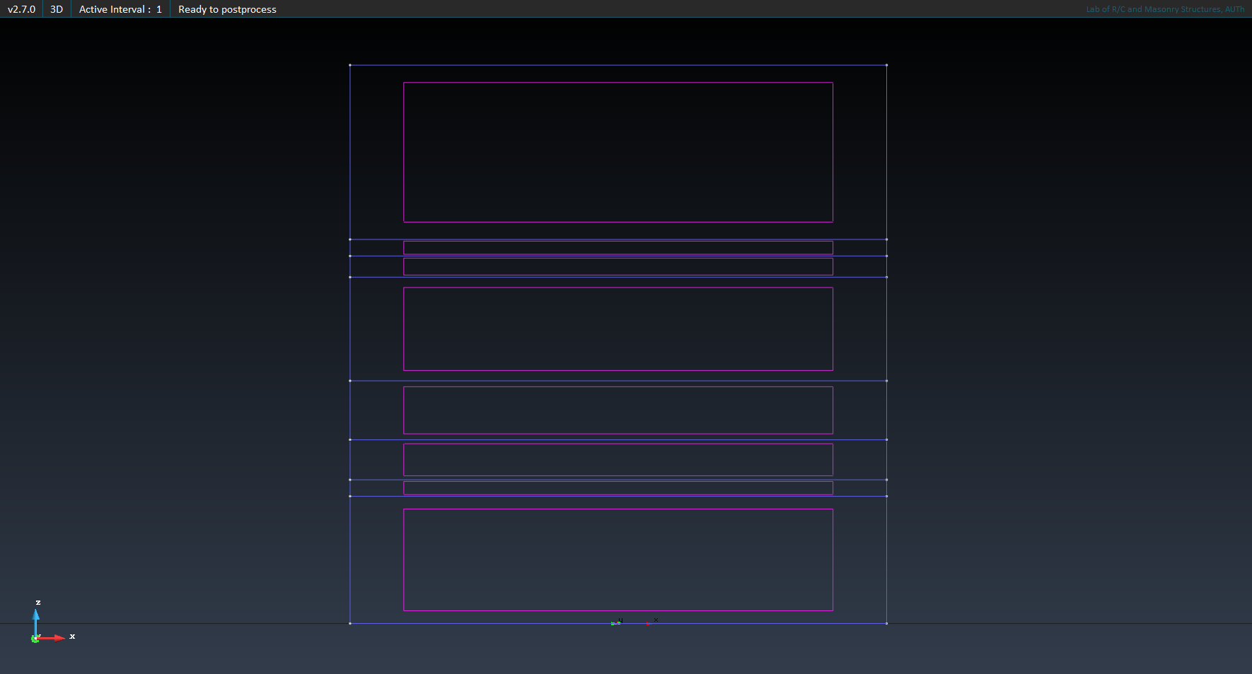

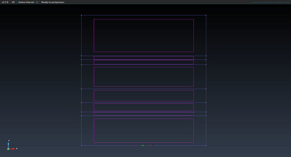

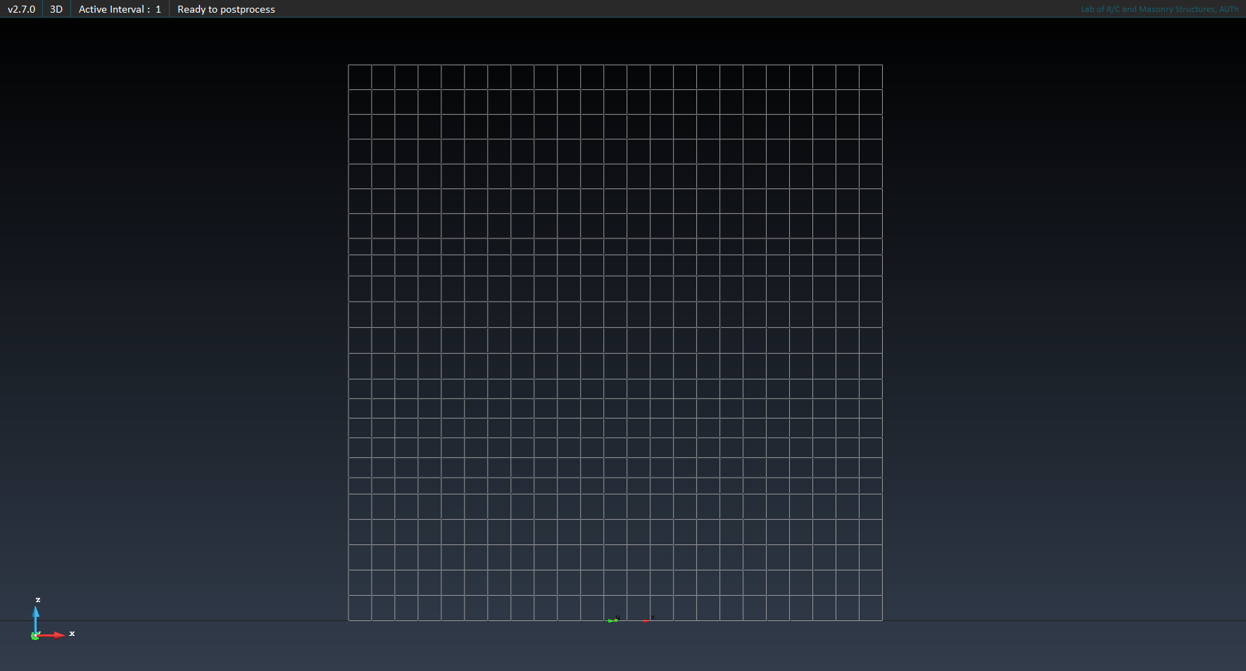

By the images is not possible to know how are the element connectivities, attach a zip with the model
