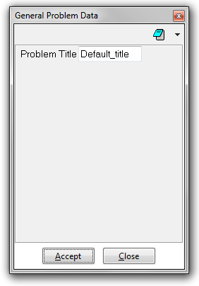

However, I don’t find any way to increase the size of the graphics windows created out of the code. I mean, there is an option of “BOOK” to generate windows, how do I change the size of this window?

The use of ‘BOOK’ in the .prb file (to define general data in a problemtype) allow to separate data in sub-menus and separated windows, as you said.
The final user could resize the window to fit its requirements (click the border and drag it), and when closing the window GiD will remember this size (it is saved in the gid.ini file located on the user settings folder, this folder name and location is platform dependent)
